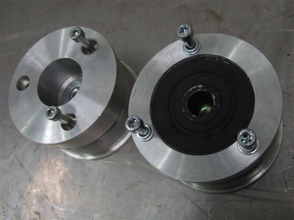

VWRacing offer 'Fast Road' hard bushed mounts or 'Race' solid mounts. The Race mounts will transfer more sound and vibration from the engine bay but will firm up the drivetrain to the maximum. I know friends who use VWR Race mounts in their road car and are happy with them but they also regularly do track days.
There is also the choice of whether to change all three engine mounts or just the dogbone one. Mark Farmer at VWR advised me that the dogbone one was the mount which would give the most advantage and to leave doing the other two at least to begin with. The 2.0T FSI engine is well known for having a fair amount of movement and twist under power in the GTI chassis. It's typical of Mark to advise what's best for the car and most appropriate for the driver rather than sell you the maximum.
^ Race mount on the left, Fast Road on the right ^ The VWR mounts have an additional three bolts fixing.

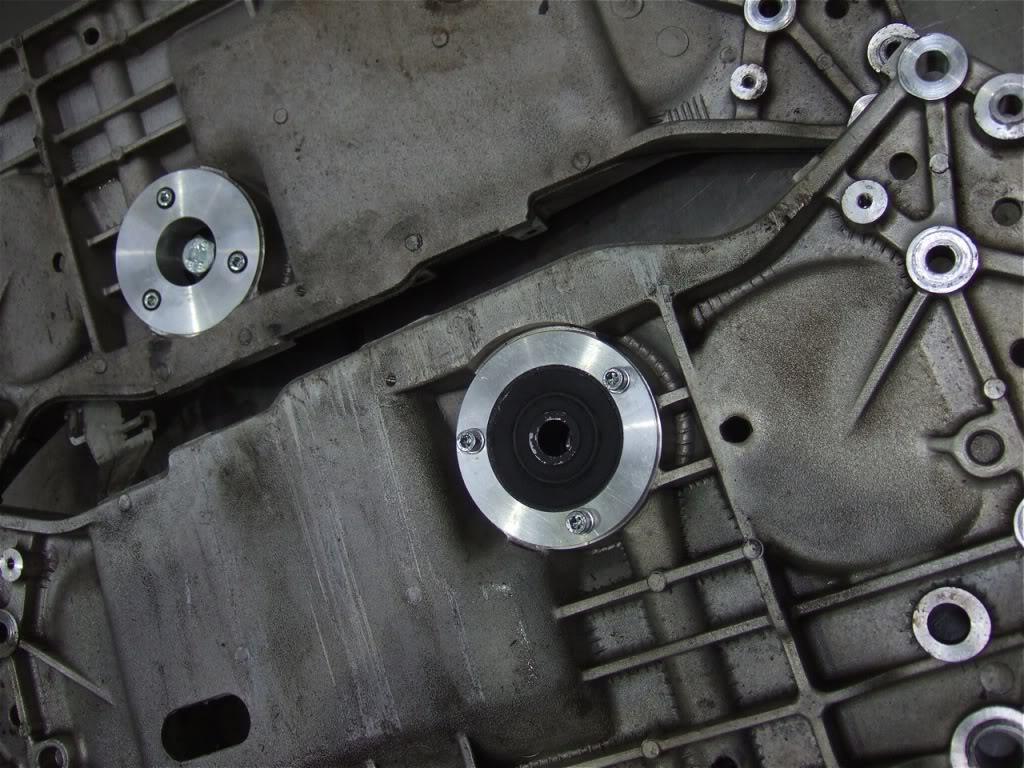

Completely different angle of approach compared to the VF/BSH kit. Looks amazing. You have to drop the subframe to fit it??
The OEM arm has a voided bush and I could easily bend the arm at this joint, such was the compliance.. but, it completely depends on how load is transferred down the arm, it may not make that much of a difference?
By comparison, the VF/BSH kit still retains the big rubber bush VWR replace, albiet filled with an insert which is far from ideal, so swings and round-a-bouts. I guess there has to be compliance somewhere, otherwise you may as well just have the race bush, I dare say you could combine the two???
....Sorry, but I don't even know what the subframe looks like!
The VWR Fast Road bottom mount has an ideal amount of compliance judging by the improved balance between less engine movement and direct power felt when driving. Also, there's no vibration in the cabin and (unfortunately!) no noise increase I have registered yet.

Subframe is the giant bit of metal it fits into, you've shown a pic of a subframe off the car above.
Sounds like its working well, has it passed the acid test for wheel hop??
Sideways yo!
Re: VWR Dogbone 'Fast Road' Engine Mount - Review....
« Reply #8 on: May 29, 2009, 12:10:18 pm »
This is my subframe on the bench : -
Plus one Simon was working on for one of the race cars. You could be forgiven for thinking this shot is of the underside of an alien spaceship.
