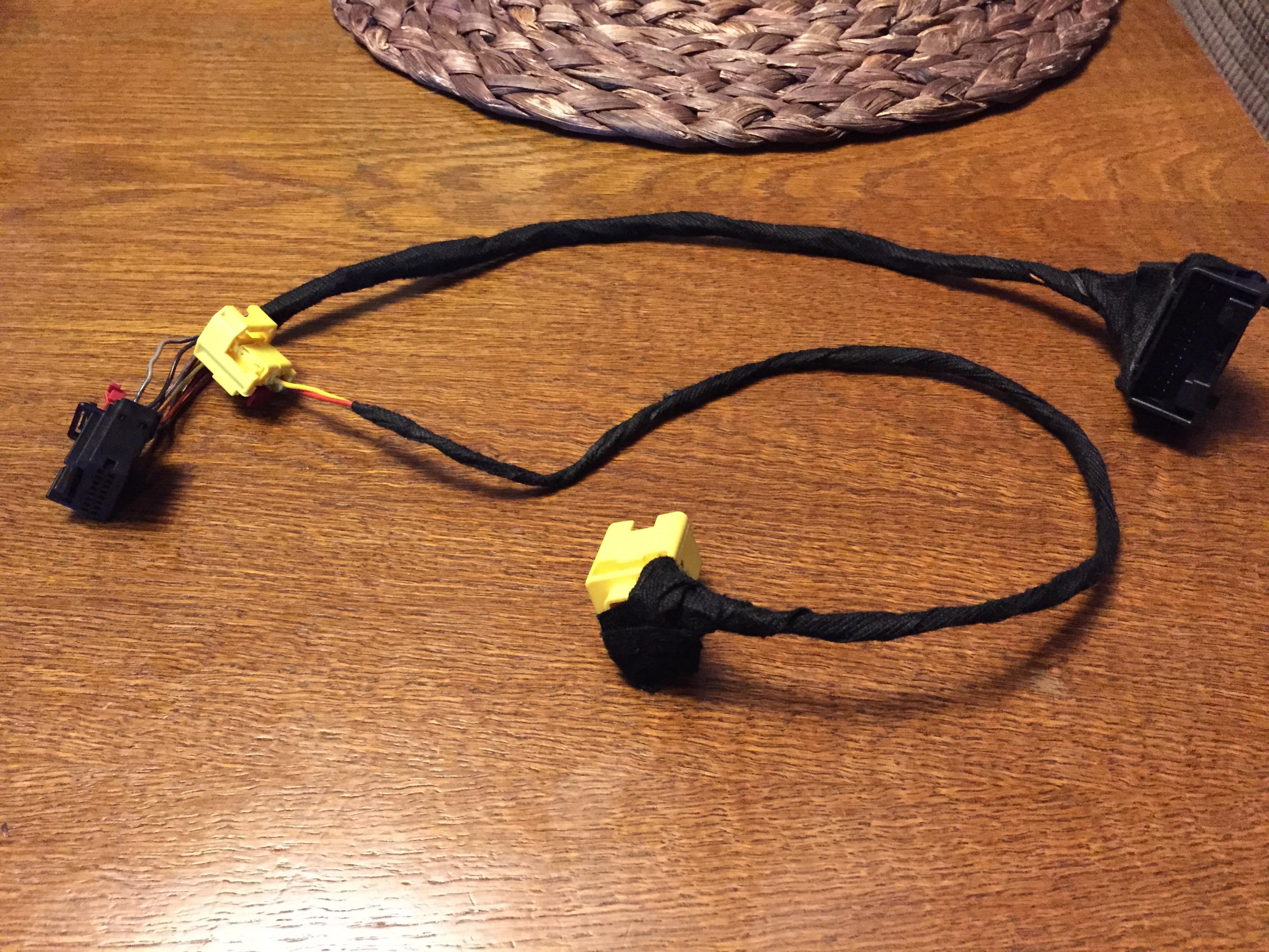

Fitted R20 steering wheel into my MK6 (with the same 1K0.. CH steering module as MK5) and all buttons work but they wont illuminate. Yet.
To get your buttons illuminate on MK5 you will need to swap the steering module from newer model 2010up. To make it easier I made myself wiring adapter so I can always remove it and put original module back.
I test fitted it in my car and on ady-uk 2005 MK5. All works as it should, buttons, illumination etc.
Also tested 3 or 4 MK7 and Rocco wheels with cruise buttons and non of them works with 1K0 or 5K0 modules. Only the one without cruise buttons works.

So it transpires that illumination will actually never work, I need the CH controller (but knew that would probably be required) and also I need a modified loom to make the horn work.

This is now all working (due to me missing the MFSW wiring completely thanks @olsen-72 ).
I replaced the controller with the CH version, nav etc all coded up. Needed to do some basic settings on the steering and abs systems. But no error codes now.
Illumination still doesn't work unfortunately. If anyone else comes up with a solution, it would be great to find out.

No loom modification required. Make sure your new steering wheel and airbag come with the correct loom. Just need a CH controller coding correctly.

No wiring changes were needed to get the horn working.
Illumination is impossible without a Mk6 steering rack.
I'll probably look at swapping mine at some stage with someone that has a Mk6 Edition 35, as they can get the illumination working.
