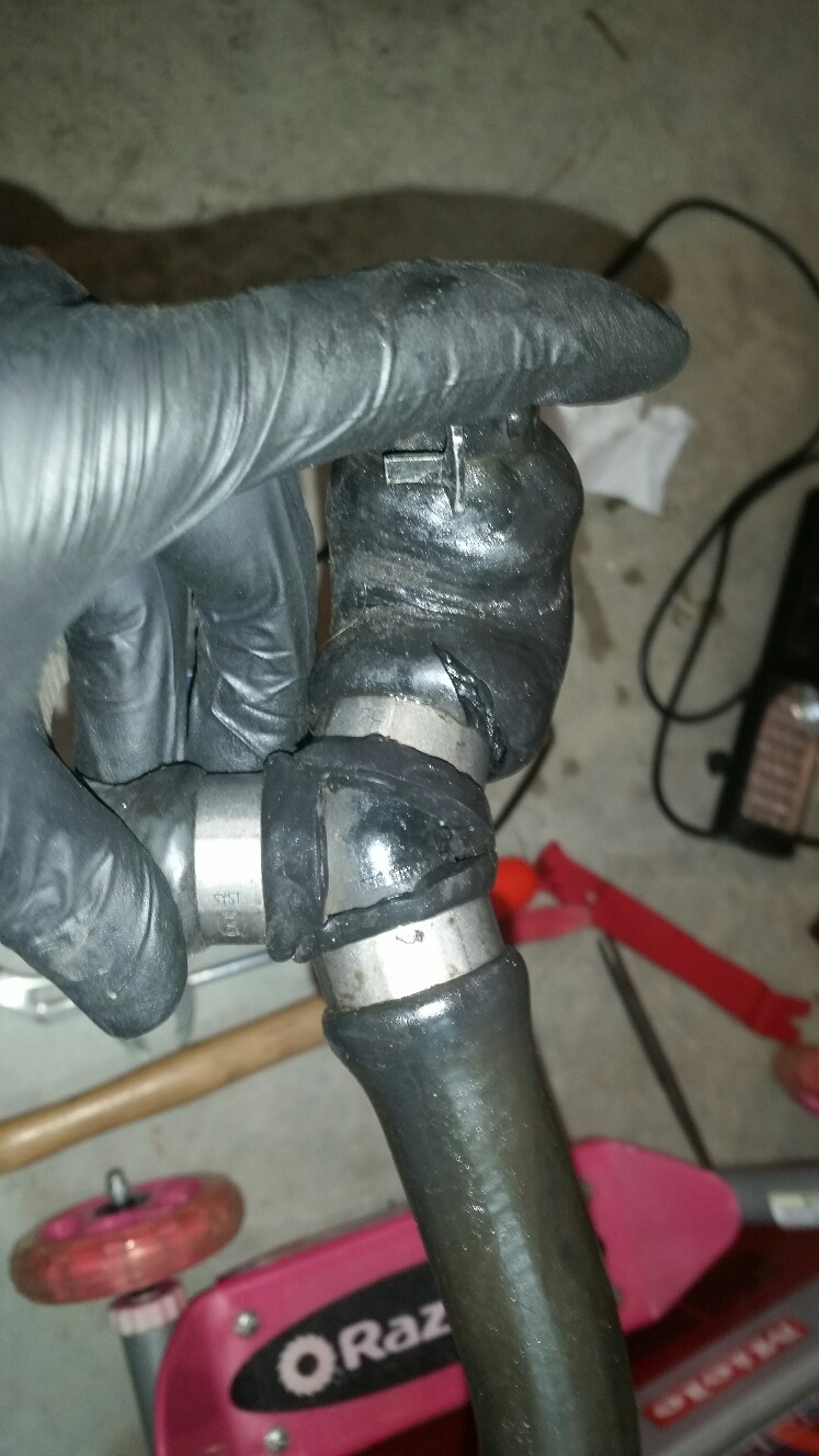

Done a bit of work on the beater recently changed the injector pump gasket as its been leaking for years.
Decided to change the thermostat as the gauge has never got above a quarter in the 5 years i've owned it.  :ashamed:
After changing the thermostat there was a leak when the needle got to 90 so i replaced the thermostat o ring again  :rolleye: (should have more faith in my diy skills.)
Then i found this.
I've also changed the temp sensor. The car is warming up now but the needle floats above the half way mark. VCDC shows a temp of 92.7ยบ. Is it normal on older cars for the temp needle not to stay put?
