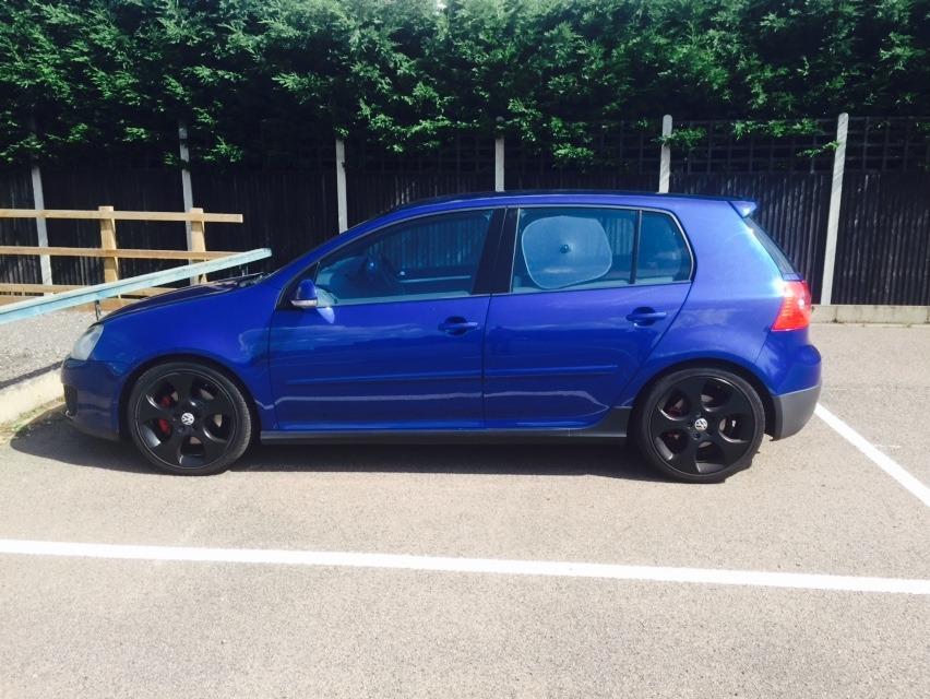

I am trying to work out if my gti is already lowered or not.
Who ever is on the std suspension pls can you tell me the height from arch to tyre

Took a pic of mine

Doesn't look lower to me mate, maybe the dark coloured wheels just gib the illusion? Can't you see the springs? Should be able to see if they're VW or not

Have a look at the springs. If they are black and have 3 coloured dots on them, then they are OEM. Aftermarket ones are usually red or blue.

They are black. Just trying to work out my the ride is a bit rough. My mk4 gti wasn't that bad

Reply #6 on:
September 01, 2015, 08:38:36 pm »
Quote from: Vwgtiking on September 01, 2015, 06:47:24 pm
Mk4 suspension was much softer than the Mk5. And that does look 20-30mm lower than standard to me.
Measure from floor to top of arch, aligning the tape/ruler with the centre of the wheel.

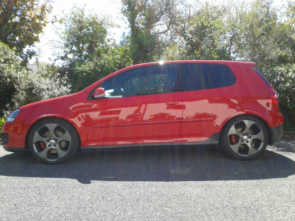

This is mine on H&R 30mm when I was on Monzas.

Re: Std gti ride height
Reply #8 on:
September 02, 2015, 07:21:39 am »
I would say that's standard, it's about the same as mine which is standard.
