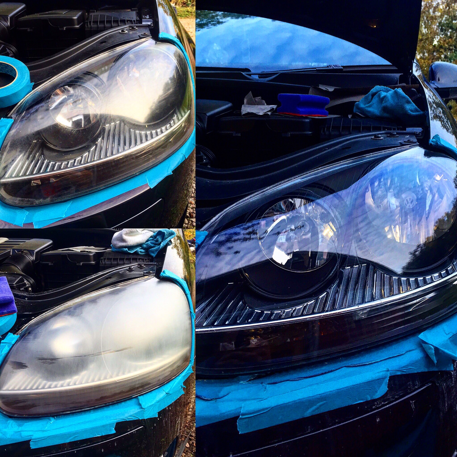

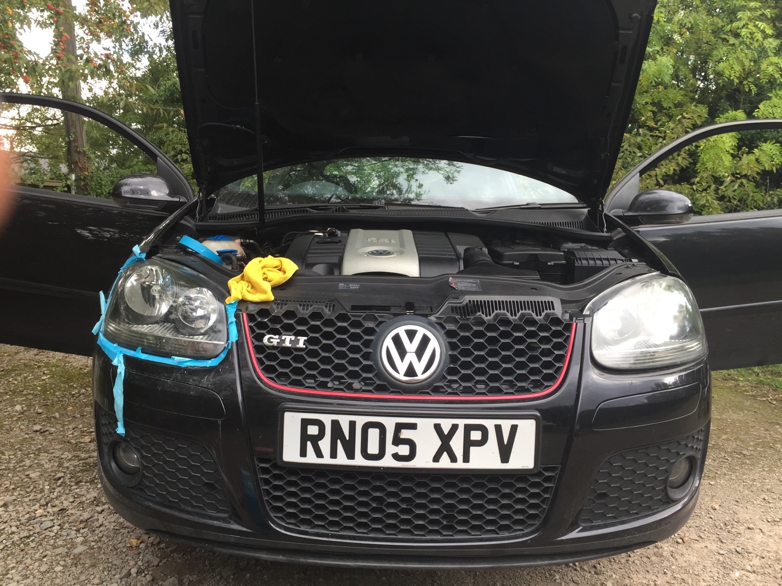

That's some difference, tell us all how you cleaned them up !!!
Silver is the way !
Offline white91
  • Posts: 586
Re: Headlight clean up
« Reply #2 on: September 18, 2015, 09:10:14 pm »
Wet dry sanded with 1000, 1200, 1500 then polished with s3, s17 and megs plastx, still need to do the other one tho!

Looks really good  :happy2:

That looks fantastic.
I bought a 3m headlight restoration kit months ago that I haven't got round to using yet.
I doubt I'll get as good a finish as that though.  Good job.

Good work. Wet sanding is the only way to get a result like that, don't be conned by other suggestions - i've tried them and they all failed, only wet sanding and then plastic polish got results like that on mine.  :happy2:

Any advice on sealing up? Some use lacquer some use wax?

I wash, QD, seal and wax. I think the idea is to keep up with it which i was doing but the last 6 months has been an epic fail as far as me, the car and detailing have been concerned.
Managed to give my lights a QD and wax today - it's piss poor but the best i can do at the moment, i'm time poor beyond belief  :scared:
