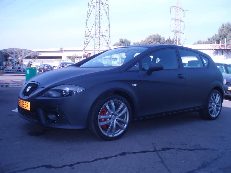

I am just starting to build my car (Seat Cupra, but same chassis as mk5) and I am extremely unfocused in what direction to go with my coilovers.
that's the car :
The car, although is a daily driver is really a "toy" and is meant to be in the end very dynamic and sporty.

Very nice leon by the way!!

about the car, its just starting out , big plans to come.

Oh, loving the matt vinyl  :happy2:

its not vinyl its painted matt black
Now being repainted at 200 miles on the clock in lambo nero nemesis
Specialist flying from germany monday to do it

what colour is that -lambo nero nemesis- any links.
