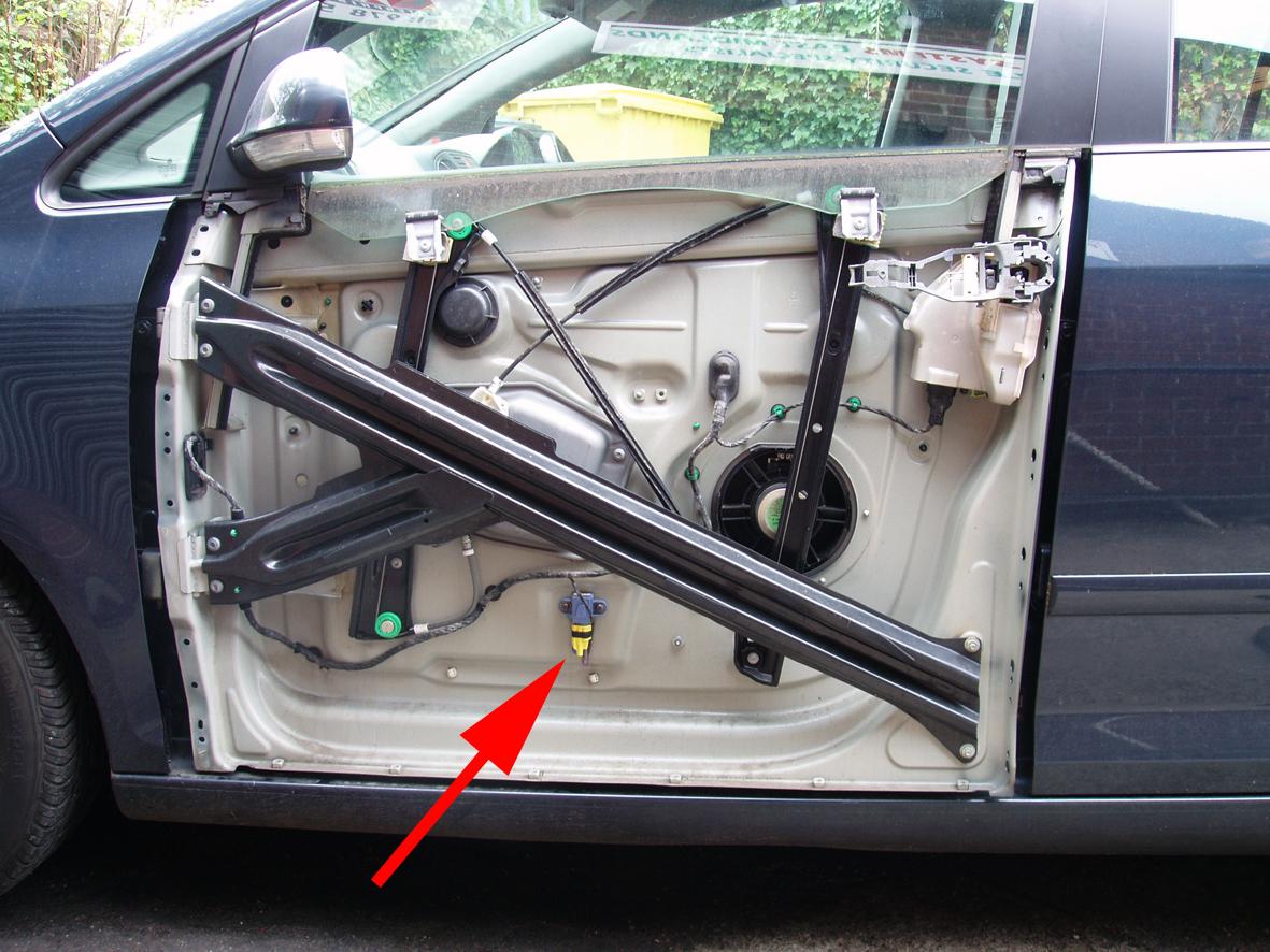

The drivers side crash sensor is hidden behind the outer door skin on the drivers door,  so the wiring goes through the door rubber in to the car.
The wires over time inside the rubber can perish and snap the copper even though outside insulation looks OK,  I'd start looking inside the door rubber on drivers door for broken cables.
If you Google vw g179 sensor 2 of the first pics that come up are of the door wiring

I've been advised that it could be the door wiring loom itself, like you say, it might perish over time, and now that my car is getting on for 11 years old at an '04 plate this may be the issue.
I'm pretty sure that we looked here and couldnt find the sensor shown on this guys photobucket
[/URL]

I doubt it's senor as your car is so old it will 98% be wiring in the rubber between door and car
