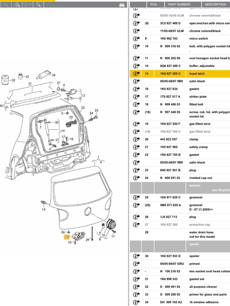

If I put my ear to the latch mechanism and pull the badge handle I can hear clicking.  I don't know if the motor inside the actuator is seized as I know they are meant to be lubricated.  Also, does anyone know the correct part number for this unit.  Correct me if I'm wrong, but the reason my wiper, fog and reverse light aren't working is because of the failed boot latch.  At least I can hear something clicking inside of the latch, indicating that theres power there.

« Reply #1 on: November 22, 2015, 12:02:35 am »
Not sure on your problem but hope this helps for part number
