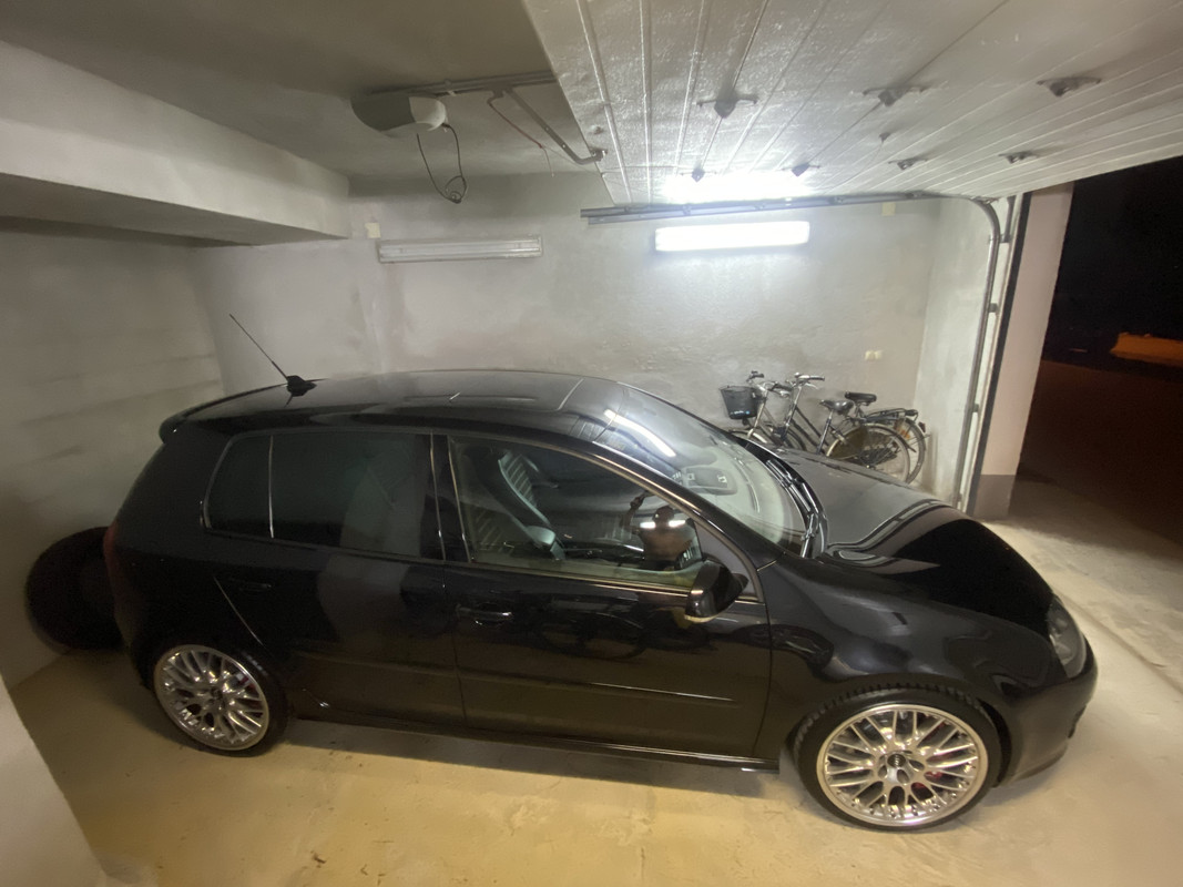

« Reply #295 on: July 18, 2025, 08:28:16 pm »
It’s been a while again😅…
Had the chance to drive the Eddy again today😍
20 Years had to get a fresh MOT… so had to move the Eddy…
My little nugget passed without any faults 😎😍❤️… in about 3 weeks I’ll be back in 🇭🇷 and post some progress from the 20 Years👍🏻
So 1 v-dub moved out of the way for the other one…🥰

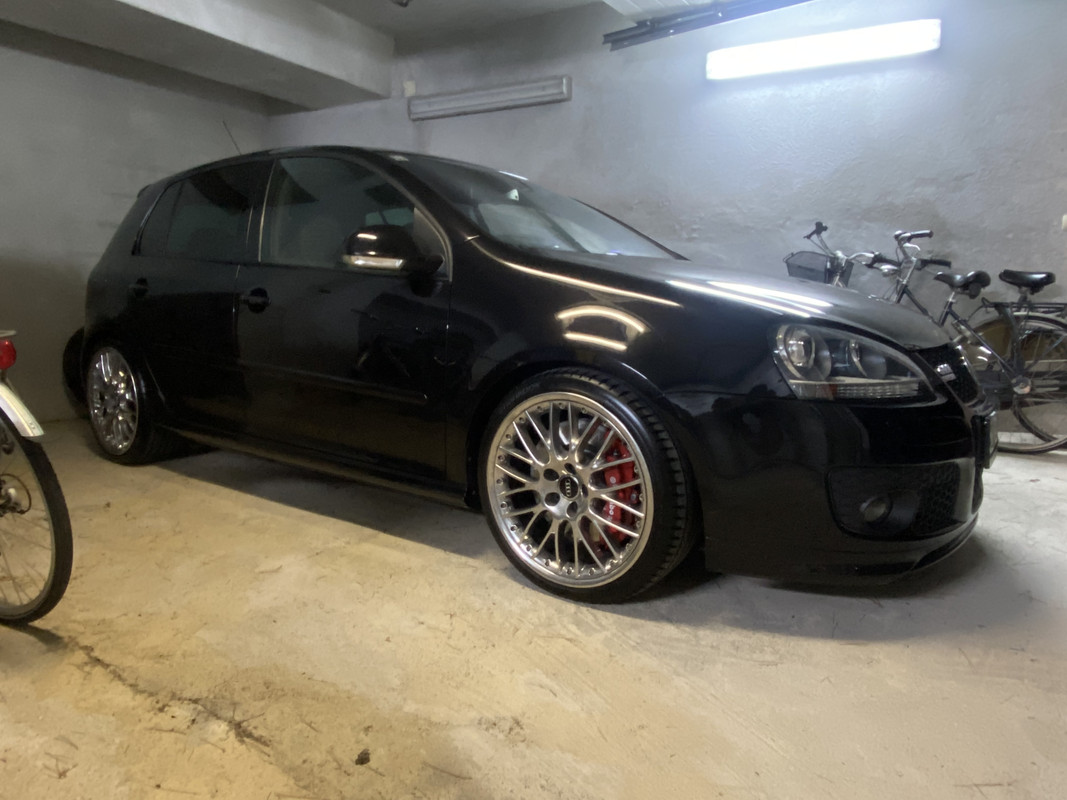

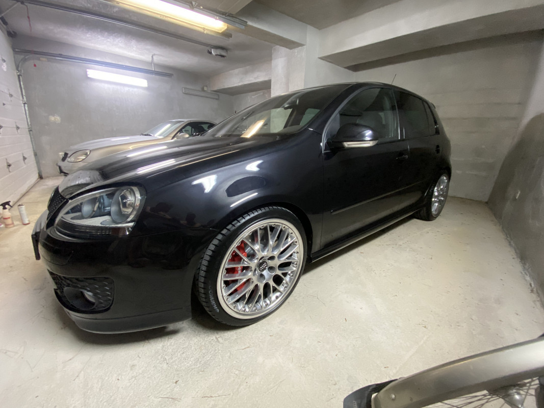

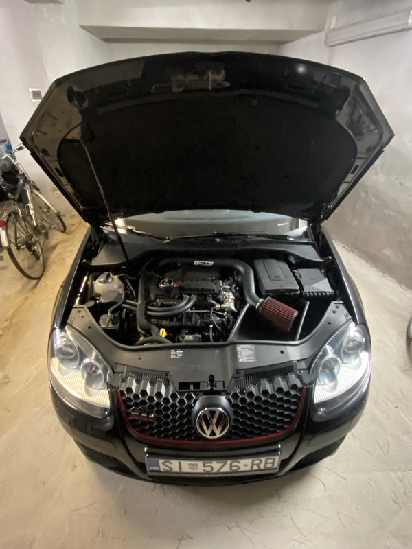

« Reply #298 on: September 13, 2025, 12:38:19 am »
And we’re back😎
Last couple of months were bussy bussy😅 but now I’ve finally got some time to go to my local VW meet in Šibenik🇭🇷
Washed the bugs & dust of the Edition 30 from the last couple of months😅
Looking all shiney now….
Went for a Sneek peek….
All is Looking good for tomorrow 😍….
