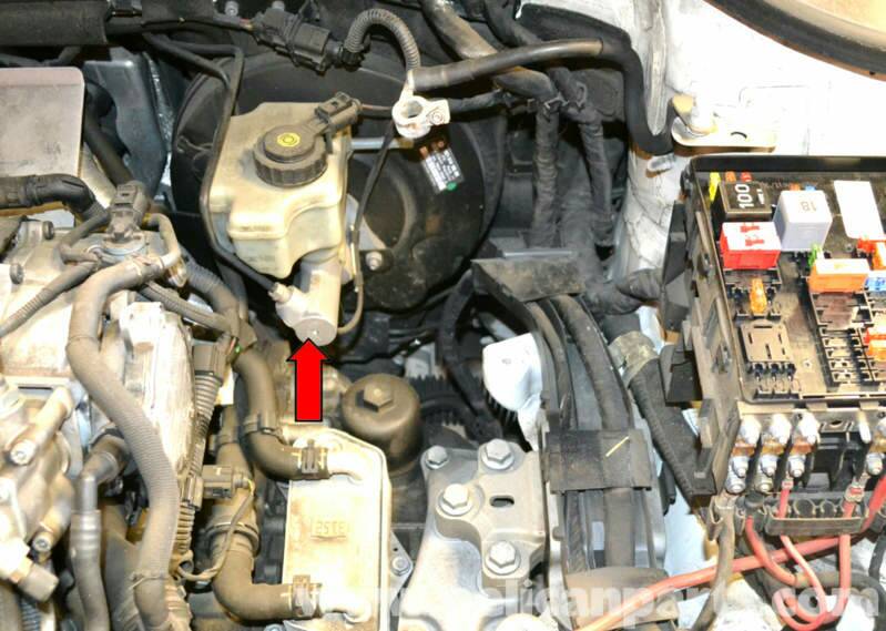

« Reply #53 on: March 22, 2016, 03:17:50 pm »
Under the resevoir. Pic courtesy of Google..

« Reply #54 on: March 22, 2016, 04:03:39 pm »
Cheers for the pic, but is that not the brake master cylinder?   It's the clutch master cylinder I need to find  :smiley:   Or does the MK5 have some kind of weirdo shared affair?!

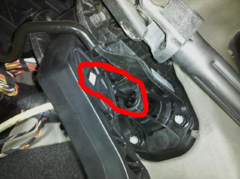

« Reply #55 on: March 22, 2016, 04:05:34 pm »
Just googled it, it's part of the bloody pedal!!! Typical!

Ah jesus yeah, sorry! Pays to read things properly doesn't it! The info above regarding sizes relates to the brake cylinder by the way..
