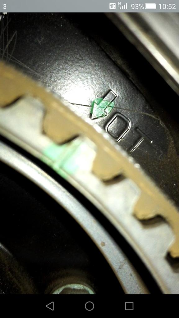

Set the crankshaft at tdc, the little notch in line with the indent in the back plate.
Set the camshaft at tdc. Cant be a hundred percent they fully line up because of the angle of the phone but I reckon it probably does?

« Reply #183 on: March 12, 2016, 11:07:15 am »
Nice one that looks good to me.
Get the rocker cover and cam chain cover off  :party:
