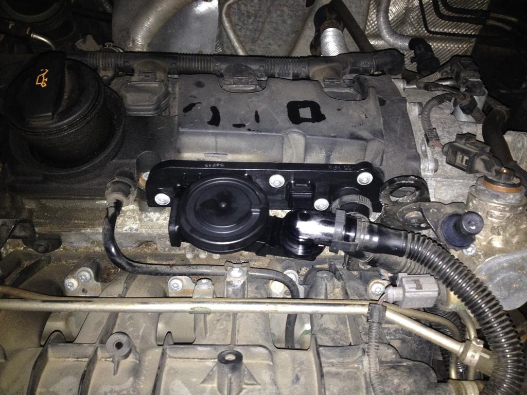

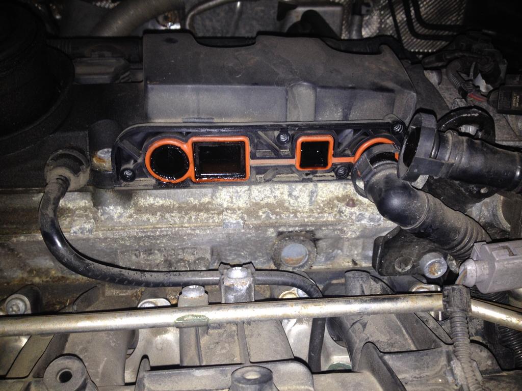

So a couple more jobs done on the car....
Did the PCV valve and gasket....
Changed out the cam follower on the fuel pump, old one looked fairly worn!   :drinking:

Solid effort pal!
Easy enough job on the cam follower?
I got a pal to do mine when I was offshore.
Offline Gmac
  • -Given: 30
  • Posts: 213
Re: Gmac's mk5 TR gti
« Reply #10 on: April 07, 2016, 08:48:15 pm »
Solid effort pal!
Well it was easy until i got to the bit where i had to remove the second pipe, which on mine is the hard banjo type!!  In the end I managed to loosen off the fuel pipes connected to this banjo to get enough play to remove the pump without removing the banjo pipe!!!  Shat myself when the pump came loose though!!  Thought I had fooked the banjo pipe, but all ok!  Reason being i didn't have the 8mm triple square/spline socket bit that fits underneath the banjo!  Right tools and it would have been easy enough.  Ordered in the right tool now though, so i've got it for next time!

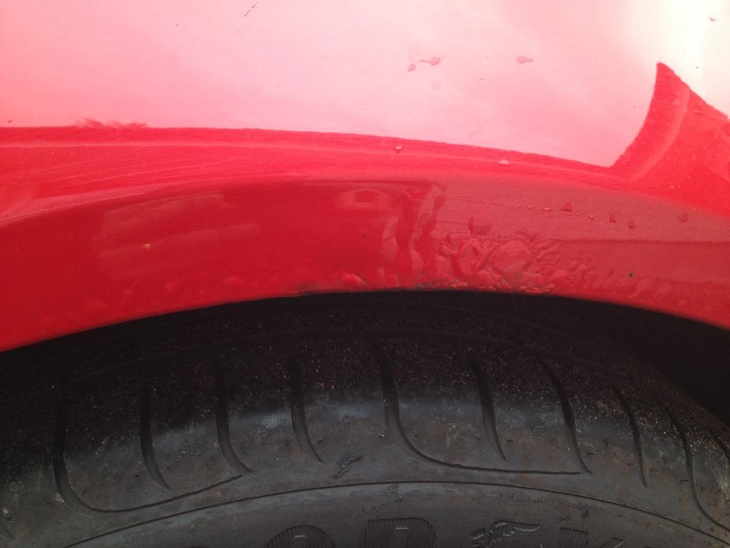

I had success with the rust on my front wings at VW, they wouldn't honour the sills though, hopefully you will have more luck.

Not too much news other than it sounds promising for a replacement front wing!  The guy in Aberdeen, Phil, was very friendly and knowledgable.  He said the sills were no longer covered, under another 10 year warranty, so that's a no go.  But he seemed to be talking like he'd see the car again for the work.  Should hear back in a week.

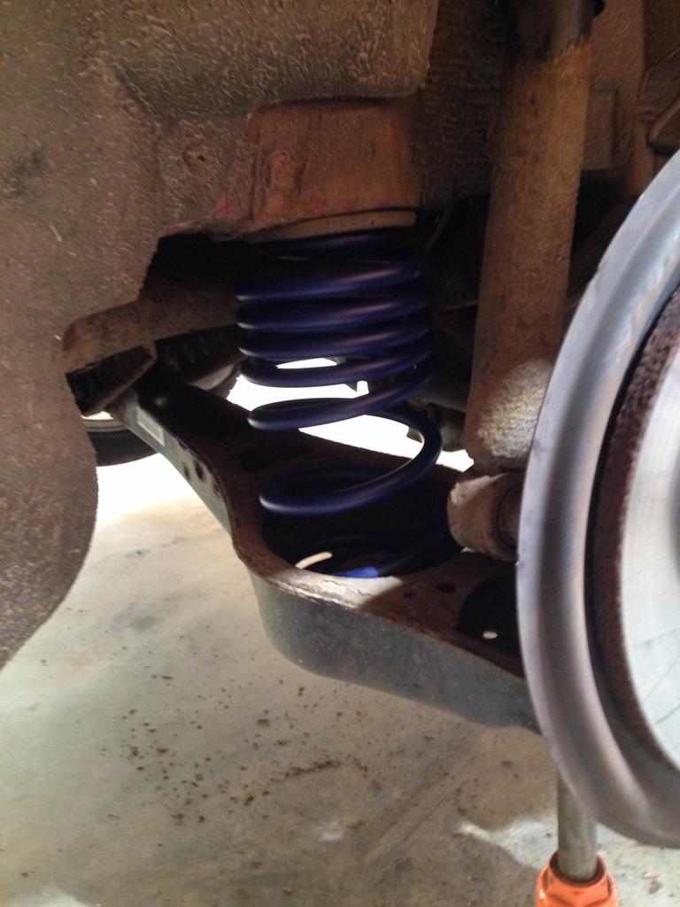

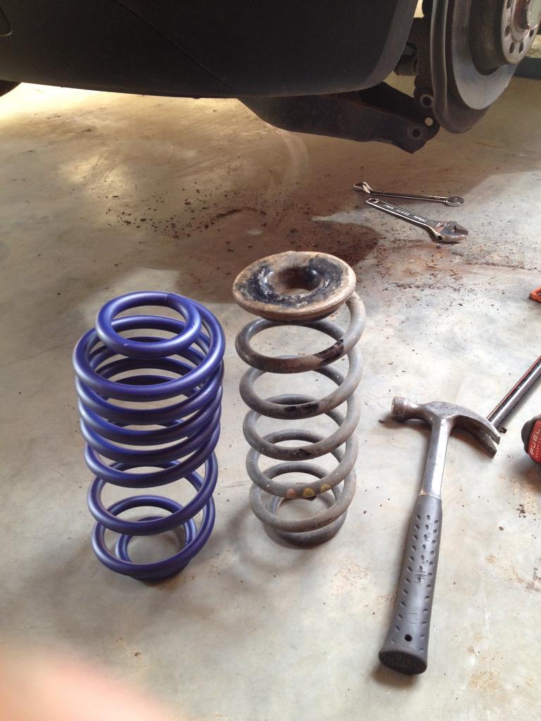

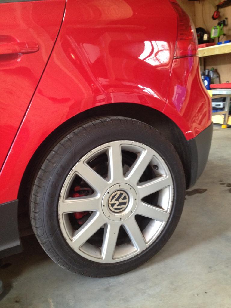

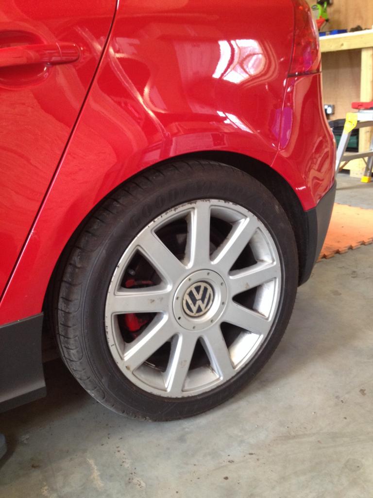

Got the rear lowering springs on today, didn't have time to do the fronts though, that's tomorrow mornings job!
Pretty straight forward, followed a guide linked from this site to vwvortex and another on pelican parts.com
In other news I met with the warranty man at Aberdeen VW body shop and it all sounded very positive for the one wing with bubbling on it!  Should hear next week.  They wouldn't cover the sills though, he mentioned them being covered under a 10 year warranty, which with mine being an 05, I was too late. Bugger.  Not to worry.
Pics..
Happy with the drop!
Before....
After....
« Last Edit: April 22, 2016, 08:24:05 pm by Gmac »
