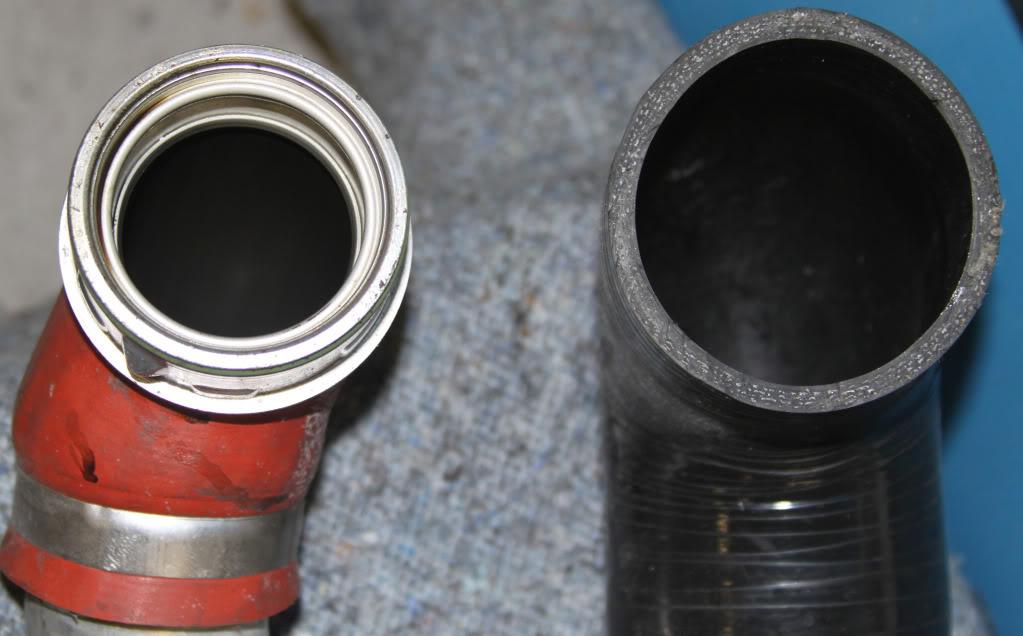

Hi,
( Thx for moving it :happy2: )
My workshop and i are working on a part that will add a bit more torque to a K04 engine, just wanted to see if there would be any interest in a product like this??
I have no idea of price atm, i will be getting the part fitted tomorrow and getting the car RR befotre and after.
I plan to upload the results as soon as i have them.
When revieving the results bear in mind that it's for a car with APR K04 software.
The turbo outlet in the picture is not ready to be fitted yet  :happy2:

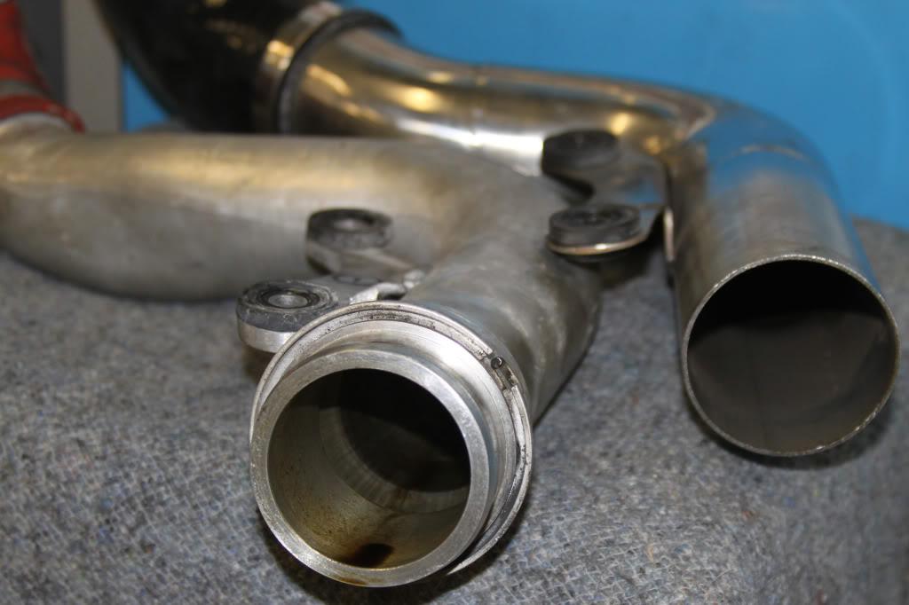

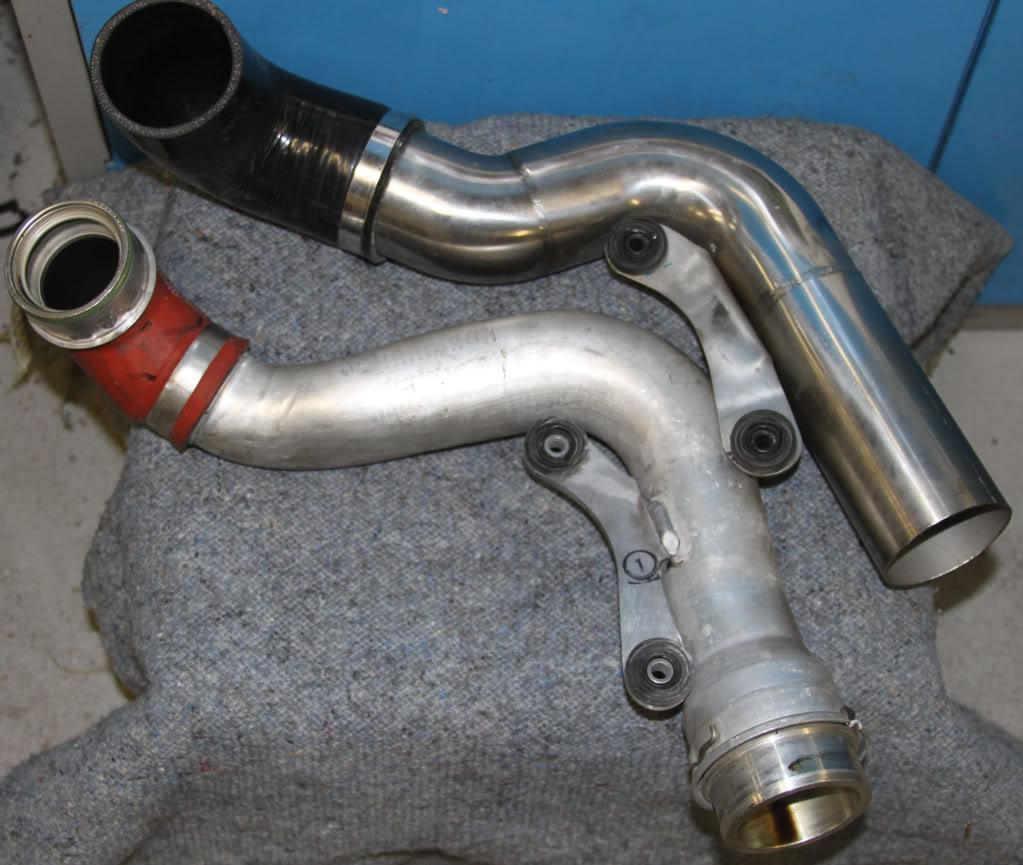

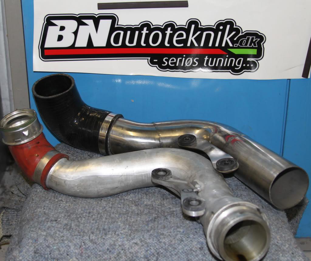

It's a Turbo outlet and tubing for the K04 a'la the one Neuspeed has made for the K03, ( I have noticed that they have had the same idea as us  :grin: )
Basically it replaces the part between the turbo and tubing for the IC.
We are fitting it tomorrow on mine and then we'll know if it's worth it or not. On the K03 stage 1 it gives app. 3hk and16nm.

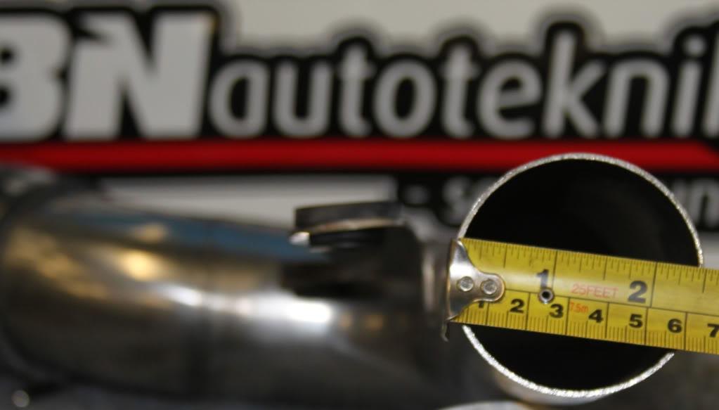

The turbo outlet is basically as the Neuspeed one except the outside flange is bigger as we have used 2,5" pipe to replace the standard discharge piping going down to the IC.

Instead of cutting in the original tube like Neuspeed does, they have made one that goes from the turbo to the IC. The part that fits in the turbo, (turbo outlet), has no slots in it like in the original part, so the flow should be better.

kinda like the SFS kit hoses then i guess, only solid. A sloid option would be good, especially if it utilised the securing mounts on the std discharge pipe.
Potential problem though is do all the differnt intercooler kits have the same size outlets, also would it work with the likes of a twintercooler etc

the connection to different intercoolers is a problem, but all problems can be solved.
this first prorotype is made for my APR IC and neuspeed pulley kit (more space for the piping).
Should fit Cupras aswell.  :happy2:
