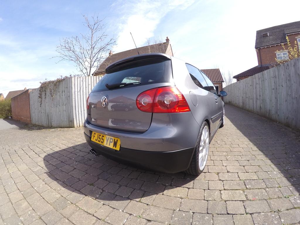

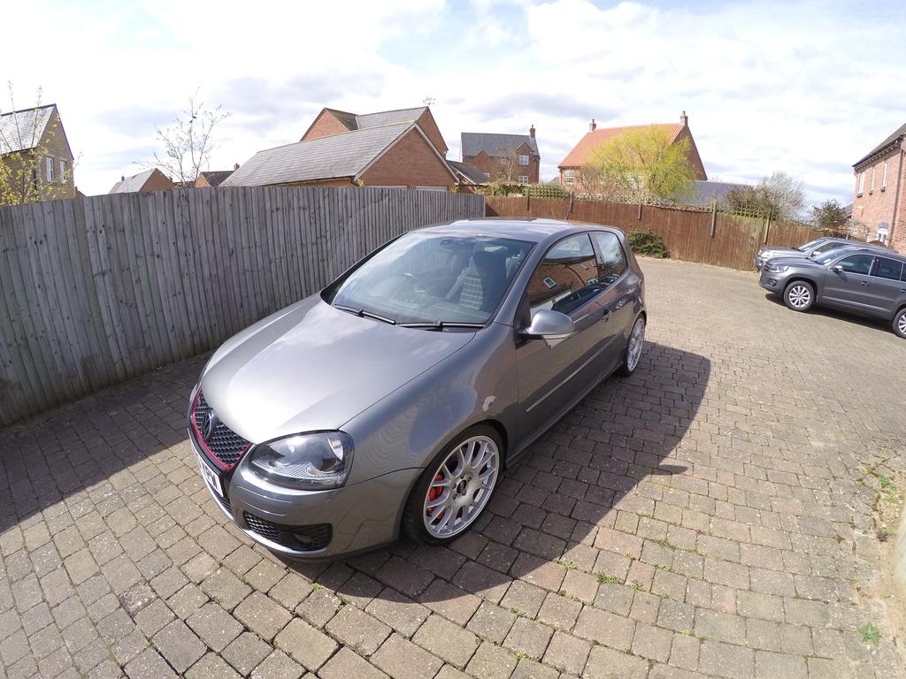

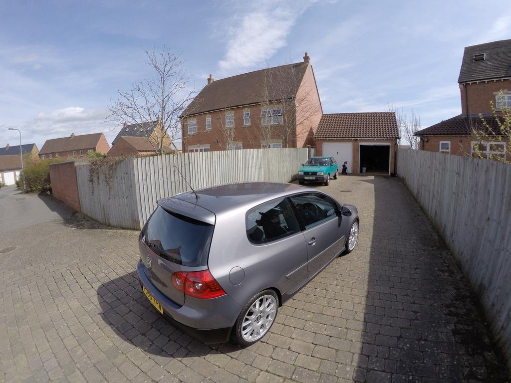

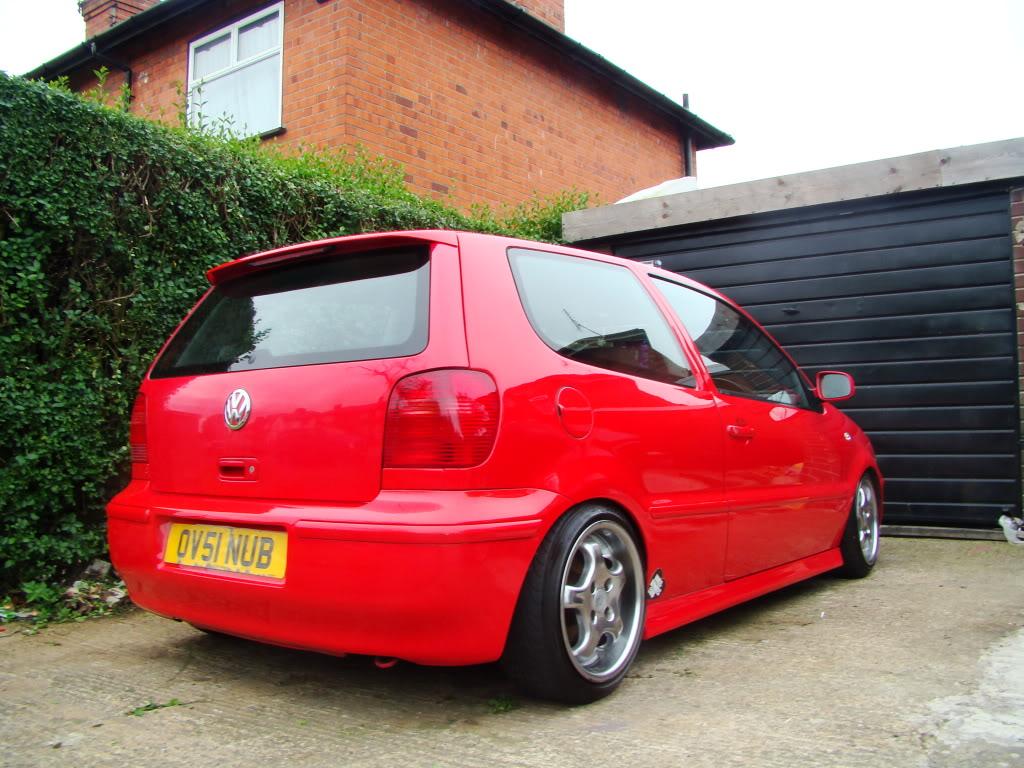

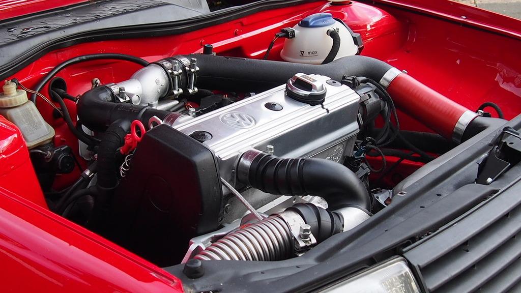

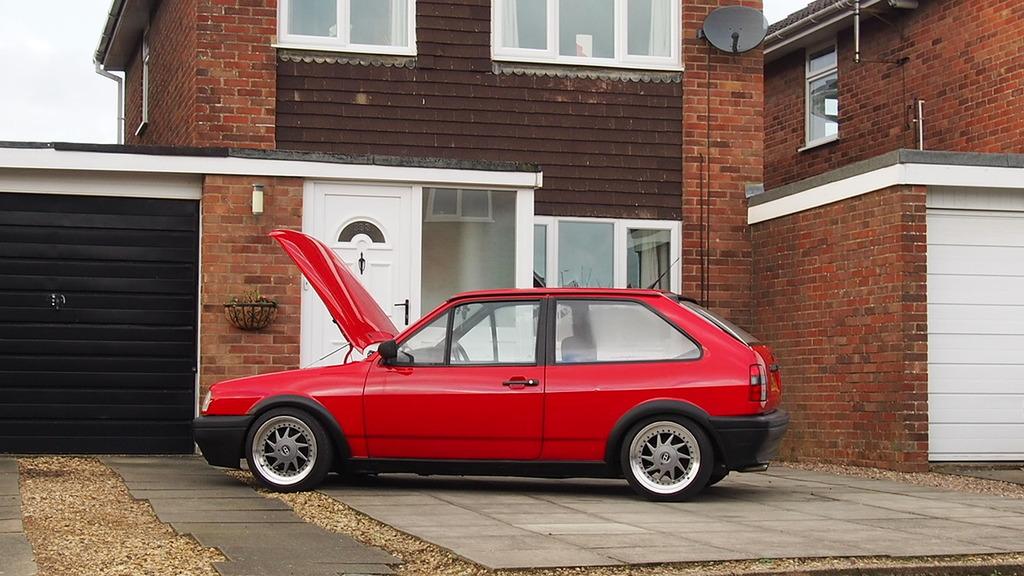

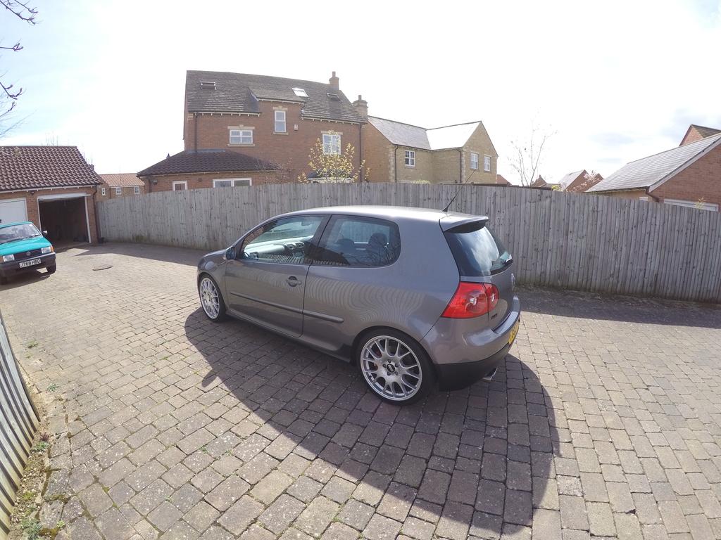

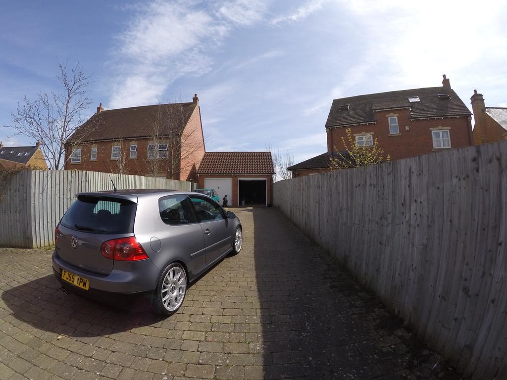

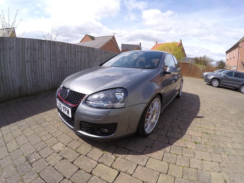

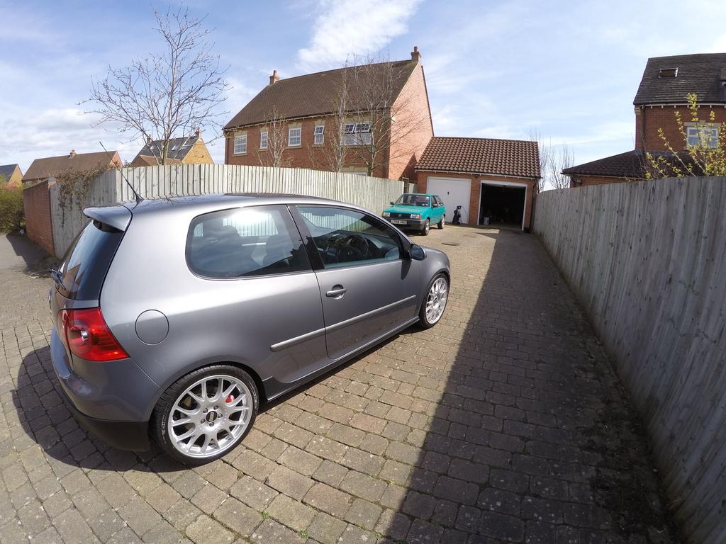

Picked the car up just over a year ago to replace my old 6n2 Gti daily and go alongside my G40, both pictured below.

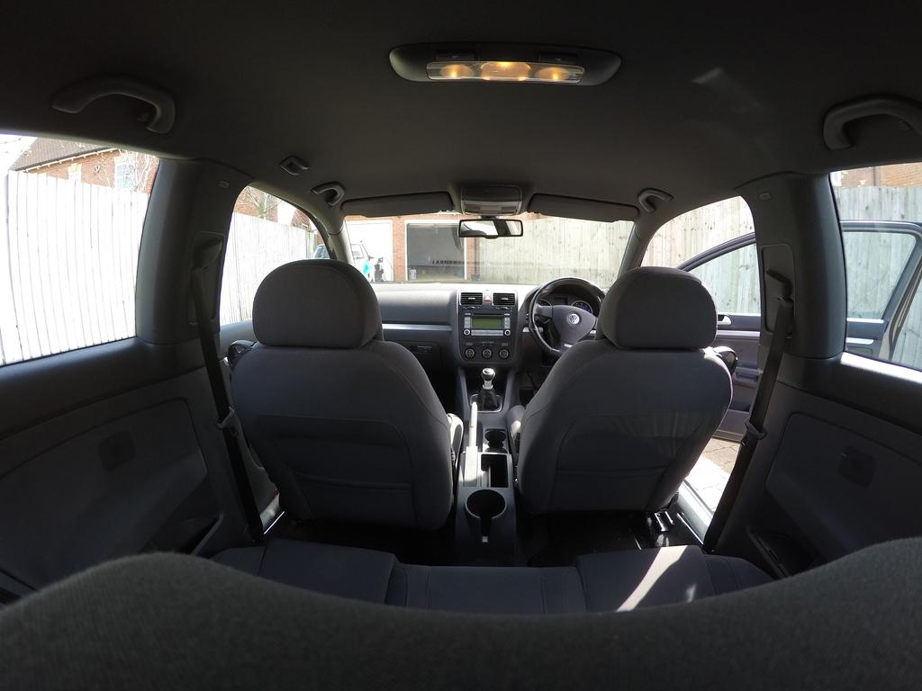

Anyways, onto the spec. After owning too many red cars i decided i didn't want another, even at the time of writing this i wish i bought a red one. So it had to be either dark grey or the dark blue. I was originally looking for something standard(ish) as it needed to perform daily duties. A few came and went and then one popped up on PistonHeads. It fitted the bill: Cloth interior, under 100,000 miles, factory cruise control and 18's.
It also came with:
Engine
Stage 2+ map by AmD
Miltek non resonated center section and rear box
Forge twintercooler
Nue speed air intake
Uprated fuel pump

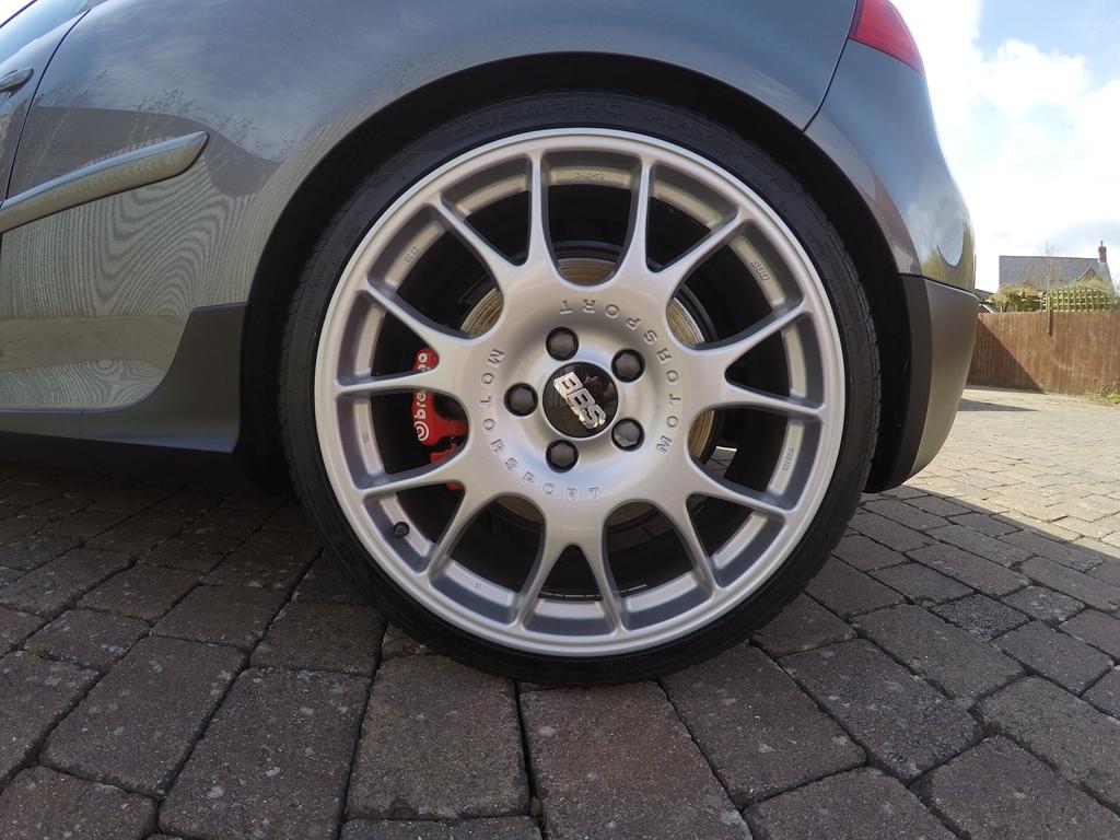

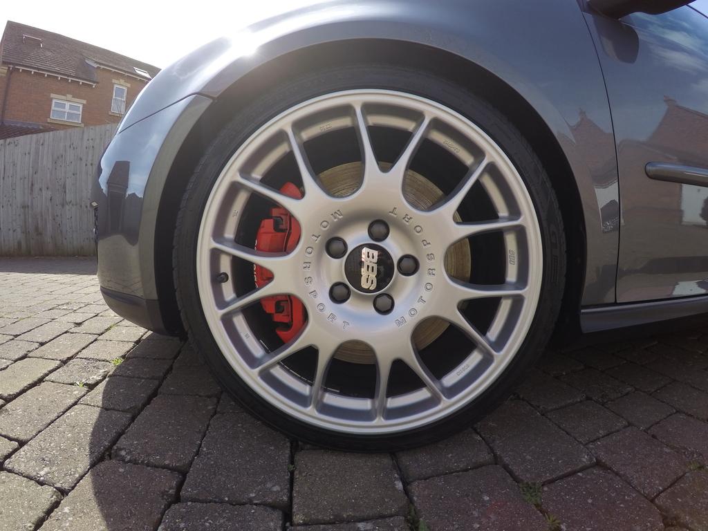

Brakes
r32 front brakes and vented rears
Wheels
Genuine 19x8 BBS CH ET50 with 235/35 Champiro Hpy tyres
Suspension
Eibach lowering springs and standard shocks
All for the same price as the standard ones i was looking at. I have owned it for just over a year now and love it, i haven't done much to it other than look after it but now i am starting to get the itch again. So here here is the shopping list, more expensive stuff will have to wait and will try to do most of the bang for buck stuff first.

Re: MK5 GTI - Big shopping list
« Reply #1 on: June 30, 2016, 12:36:43 am »
Good luck with the new GTI mate! Already has some really nice bits. :drinking:
If the rear brakes are vented you have a full R32 brake setup. The front calipers are from ATE and rear calipers are from TRW. Brembo lettering is a bit tacky in my opinion... :P
« Reply #2 on: June 30, 2016, 08:56:34 am »
Thanks for the info. :) Yeah i am not a massive fan of it. I have thought about taking it off but not sure if it will drag any paint with it. I was thinking about going blue with the calipers at some point but not sure.
« Reply #3 on: June 30, 2016, 04:32:08 pm »
Lovely mate :happy2: Well wear. Looks in lovely condition.
Wheels are great. I agree the brembo stickers look a bit naff. Especially considering the hardware is a decent upgrade from standard. Blue would look good and ties in with the R32 hardware. I LOVE your G40!!! That is seriously cool :happy2: :happy2: :happy2:

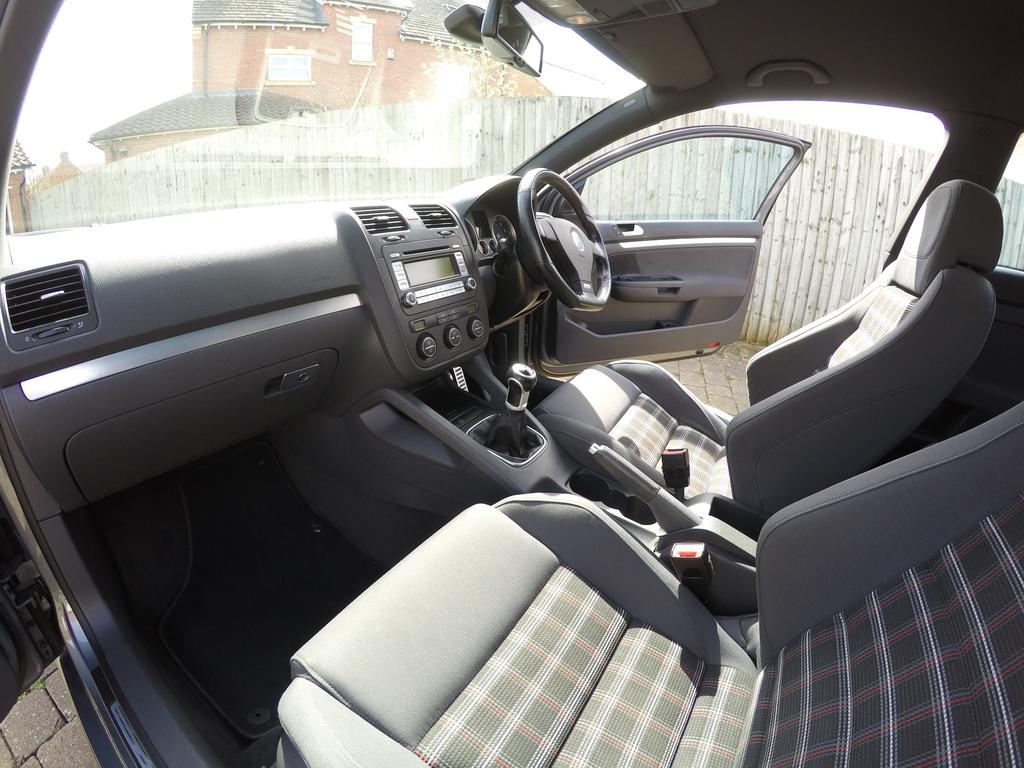

« Reply #5 on: June 30, 2016, 05:09:12 pm »

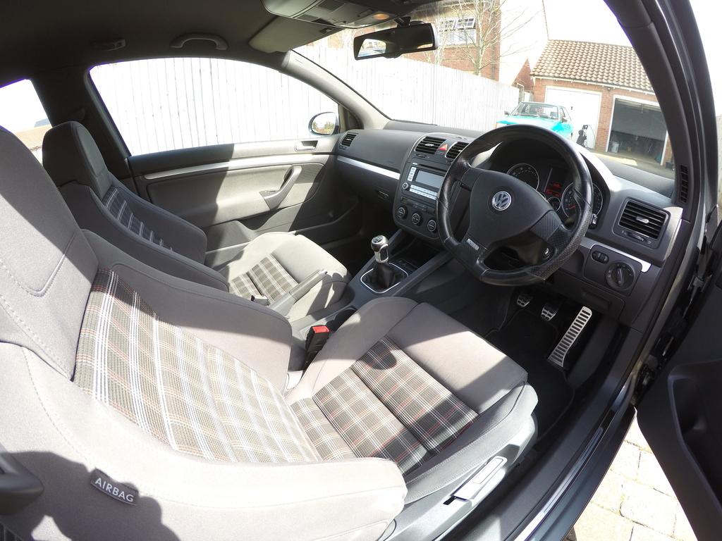

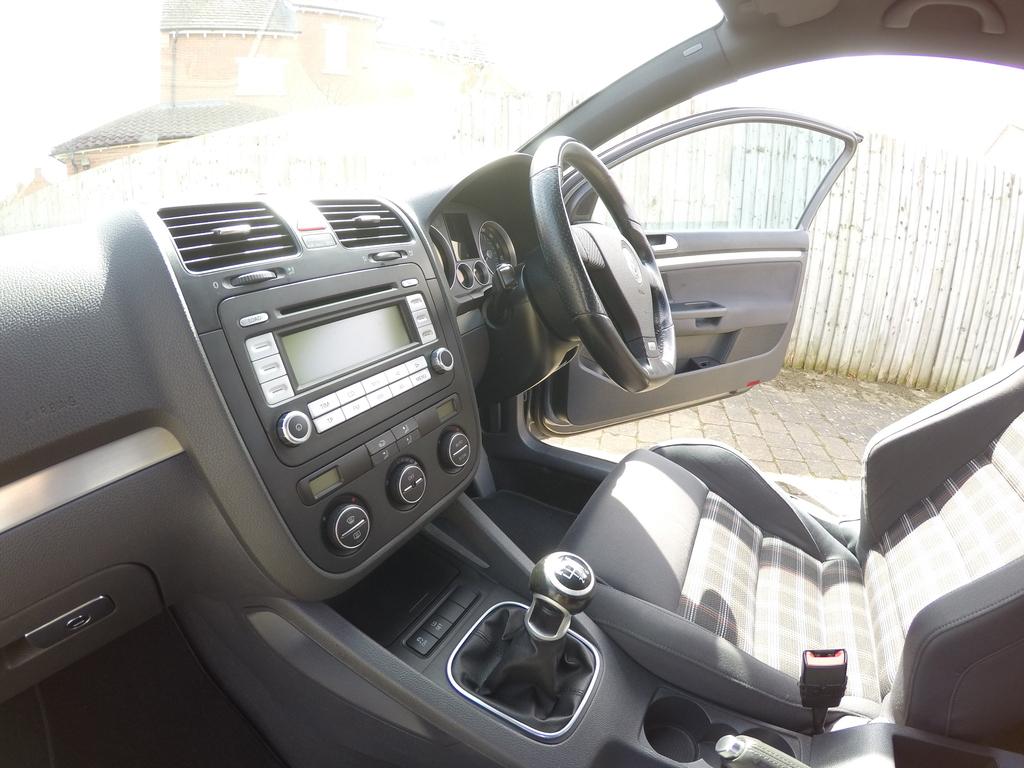

Beeby11  -you car looks decent. I wasn't aware that mk5's came with DCC or am I wrong.
the buttons in front of your gear sticks? I know one is traction at least
« Reply #6 on: June 30, 2016, 06:06:16 pm »
DCC is only available on mk6's. What you can see are the ESP and TPMS buttons.

Beautiful GTi mate  :happy2: Seeing your red G40 makes me miss mine so much. Iv owned three in total and always seemed like the right time to sell them then instantly regreted selling  :doh: Really want another one now lol

Very nice mate. Love the wheels  :happy2:

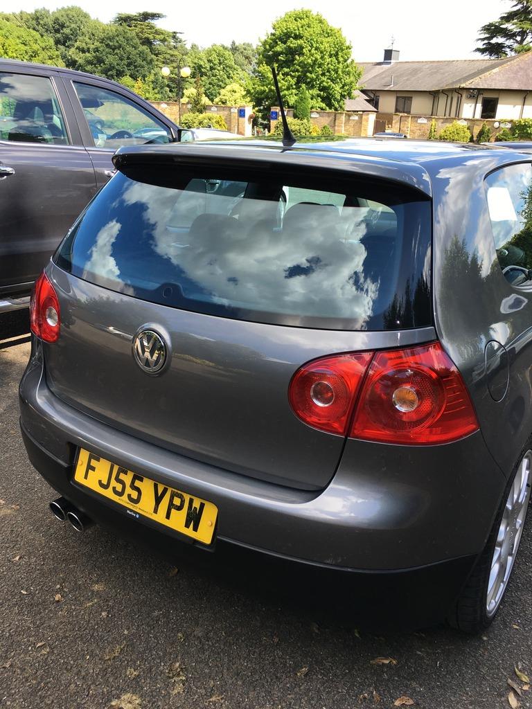

Fitted my Kill all Wipers delete grommet yesterday. I must say a really nice kit, the grommet fits will, plenty of sealant for how much you actually need and good instructions.
The worst parts are getting the wiper arm and plastic boot panel off. The wiper arm took a bit of wiggling and persuasion with a trim removal tool (if you don't have a set of these i strongly suggest getting some). The boot panel took a good tug to release the clips, but i managed to do it without cracking the panel. Once the panel was off it was a case of removing the motor, disconnect the water pipe and unplug.
Fitting the grommet was pretty easy, use a good amount of sealant as you can always wipe excess off. I taped over the back and got an extra pair of hands to hold it in place while i ran a skim of sealant over the top from the outside to ensure no leaks.
Phone picture below, but there isn't really much to see  :smiley:
