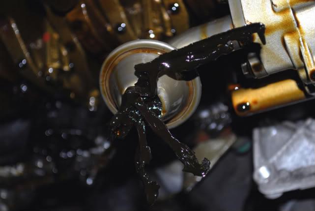

I've done this before on a friend's AAX, but I finally attacked mine this weekend.
Someone has been in there before.  Black Loctite used instead of the VW stuff.  Oil pickup was clear apart from some orange dipstick crumbs and a small amount of other debris.
I would seriously recommend just replacing the pickup (and the green O ring) because bits of crap gets stuck behind the 'lip' which is hard to get out.   But as I did it impulsively, I hadn't armed myself with any parts.  So I did what I said I was too lazy to do and scrubbed it for 20 mins  :grin:   Reused the O ring too as it was still pliable.
There was quite a lot of generic crumbs in the sump.  No idea what it was, but thankfully not metal shavings.  It's all nicely scrubbed out for peace of mind.
