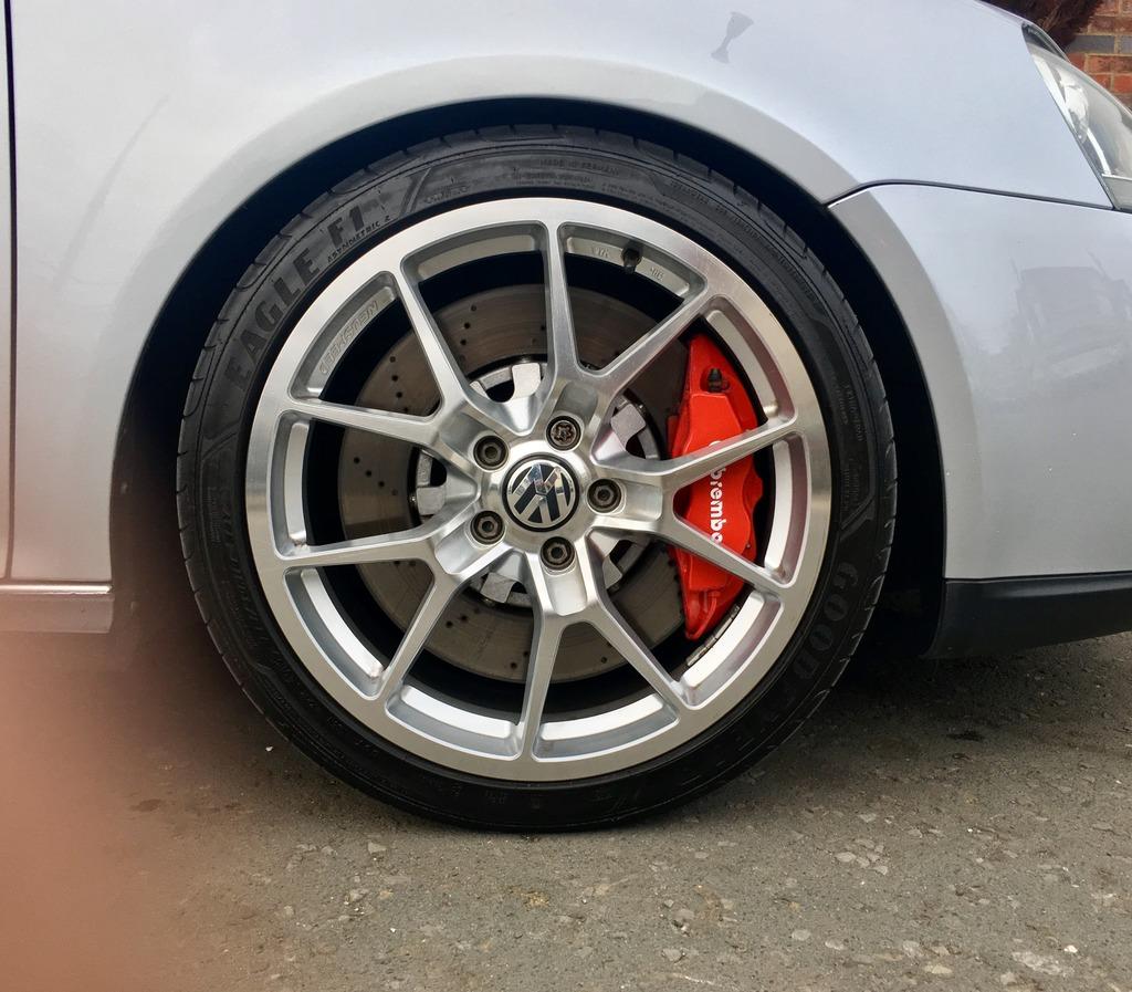

Got to say I've been impressed with the service from Neuspeed - been very responsive and helpful.
Got this pic from them overnight, the spokes on these wheels are so thin that they clear the brakes by 4-6mm! Loads of room in there!!
I expressed concern about how long Awesome might take to get these, so they're putting me in touch with an international dealer that will ship to the UK. So, as long as lead times aren't crazy, this looks like a winner!
From what they've said, pretty much their entire range has loads of clearance for BBKs - so worth considering alongside side the more well known OZ and Team Dynamics options.

Offline addictivev8
  • Posts: 54
Re: Wheel Options for Big Brake Clearance?
« Reply #28 on: April 28, 2017, 08:59:48 am »
No worries chap, the whole range seems to have brilliant clearance as you say and they're light to boot. Liking the ones you've chosen, will look good against the black paint.  :happy2:
