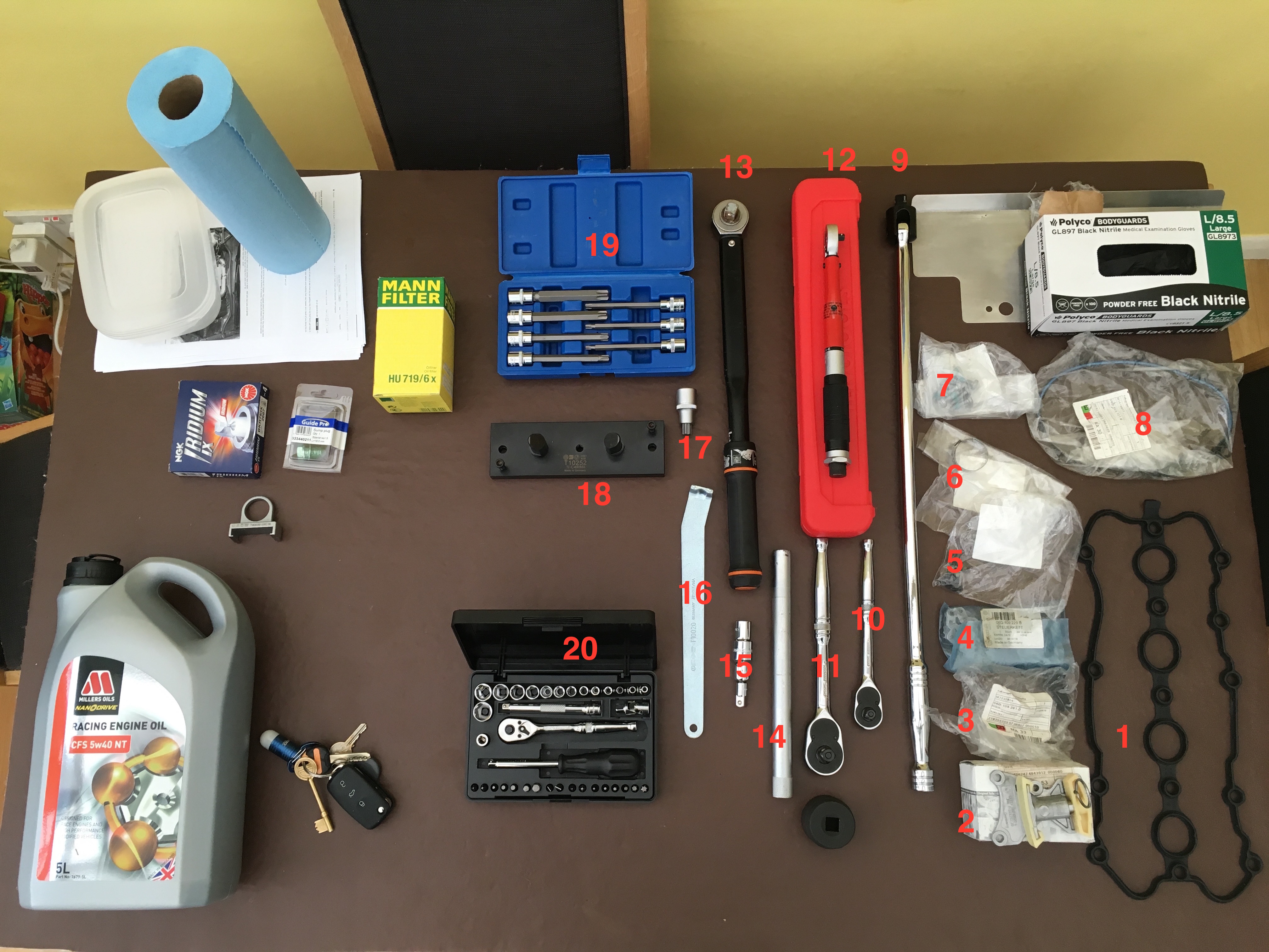

Just to confirm, they've broken two of number 17 in this pic.....
....attempting to undo this bolt?
I don't even know how that's possible!   The head of the bolt will round out way before the tool breaks, unless they've used really crap tools made of Stilton.
That's the tool the apparently broke 2 of trying to remove that bolt. That was my argument that the bolt would strip long before that tool would snap unless it was cheap soft rubbish. It's really bugging me what's going on.
