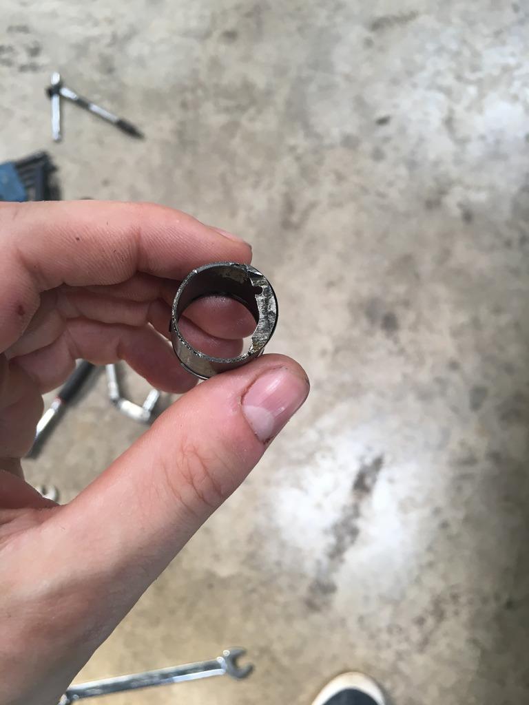

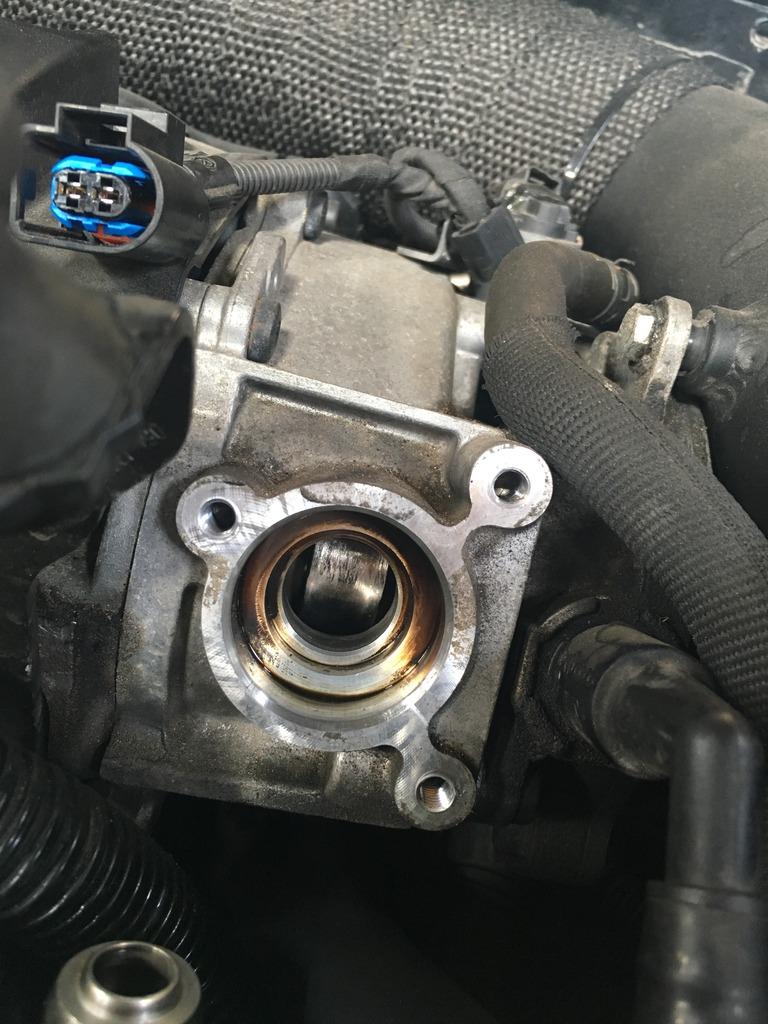

Hello all,
Bad day today for the car. Have been meaning to change the cam follower for a while now and today was the day the car went into limp mode and the whole face of the cam follower is gone (after investigating). 25k miles on a new cam with stage 2+ (I know, I know I should of checked sooner and has been an expensive lesson to learn :sad1:)
The car is stage 2+ and running the auto tech HPFP.
So I know I have cam and pump failure but my main concern is the cam shaft seemed to have slight markings on it. It doesn't look too bad but should I be concerned?? :thinking:
My plan now is to buy a new HPFP (auto tech £400) and fit a new cam follower. As I said the cam shaft looked a little marked but the plan will be to fit new pump and cam follower check after 3k-5k miles and see if the new cam follower is worn excess. If it is too worn at those miles its clearly a cam shaft problem (big money)  :doh:
Any advice will be greatly appreciated.
Jack

You were "lucky" to have gotten 25k on a CF after upgrading the HPFP. Most having done that only get 10k to 15k/CF. Yes, you should've replaced the CF at 10k miles the first time...which was hopefully a brand new CF at time of HPFP-upgrade. When my HPFP was upgraded, I let my VW tech do it at the same time he installed my K04, injectors, FMIC, exhaust, and all else. I thought he installed a new CF and expected to check the CF after 10k miles. But he reinstalled the old CF that had 58k miles on it. After 5800 miles the same thing happened to me. I was lucky that I let my VW tech do all of my installs and they covered it all with the warranty, but the bill would've been between $2k and $3k usd.
If the intake cam's hpfp lobe doesn't look like it has a mirror finish and flawless surface...I suggest replacing it to get the most out of your future CF's. I know some just leave it alone but you will not get the full CF life from now on unless you change the intake cam. Mine used to wear the black off the CF-face, and deform its flat surface, after just 10k miles and now it's getting closer to lasting up to 15k miles. The HPFP upgrade means you have to be religious about CF attention.

Mate that cam is scrap... It needs changing, along with the pump, dropping the sump to drain the oil, flushing the engine to try and remove all of the swarf that you can etc etc
You just change the pump and you'll eat followers every couple hundred miles and be in this position again in no time

That's bad news jack :sick: the cam followers need checking/replacing every 3,000 or so for peace of mind/wear rate.... new cam shafts are roughly £250-350 plus labour or maybe look into a engine change....

New cam chain/tensioner/adjuster
Full engine flush also be sure to check the oil ways from the head into the cam chain housing for metal bits
Sump off/change Oil pick up pipe... new oil/filter
