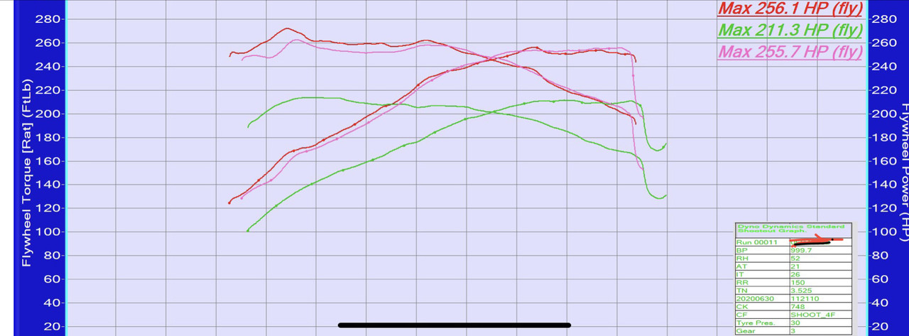

« Reply #43 on: March 24, 2021, 12:01:29 am »
@Pudding  @Beej  @colesey @AJP  @dan_fr   :drinking:
* At the bottom of this post is the current mod list and the custom map achieved on 95 Ron fuel with supporting mods.
Are we all alive and kicking?
Hopefully we’ll be back kicking the foot down in the motors soon!
Glad to see a lot of the OG’s of the forum are in this little thread.
Maybe we could get a post from everyone showcasing there current car and a list of its spec and what’s next!?
Would be nice to keep the thread going with an update from everyone.
As far as My MK5 goes I took your advice on handling upgrades @pudding and got some coilovers and fully (powerflex) polybushed the front end.
Still no upgraded sway bars and no bushes on the A*se end.
Reason being I’ve been thinking I will eventually turn the car into my version of a 4wd mk5.5 @ajp :wink:
I love the 6r too but I want this mk5 forever.
@beej you were right about the turbo technics k03 hybrid. I’m very interested in that turbo at the moment, but at the time I just didn’t have the money to take that on. But now I need to know what Tt hybrids capabilities are on 95 Ron. In Ireland we have zero petrol stations with anything better then 95ron, so mapping power is significantly lower then the UK.
Mods:
Turbo technics turbo with *360 degree thrust bearing.
Bcs 3” power valve downpipe with 200cell sports Cat into 3” exhaust
Vis internals
Rs4 return valve
Gfb dv
Typhoon induction kit
Tyres, stopping & suspension
Bridgestone potenza
Mtec front and rear discs
AP coilovers
Polybushed front end (powerflex)
Front : Porsche Brembos (the ones that squeeel)
Brembo pads
Rear:
Standard Gti calipers with mtec pads
Things to do
Gearbox Service due
Full service due
S3 or toyo intercooler?
Turbo K04 or turbo technics hybrid K03?
4wd conversion?
Tcu/dsg map
The  latest figures I’ve seen of the k03 hybrid on rtechs Facebook page (linked below) is quite impressive.
https://www.facebook.com/353560864702852/posts/2240380922687494/?d=n
I have been thinking about the 4wd conversion but on the other hand if I’m eventually going 4wd then I would be better off with a k04 conversion rather then a k03 hybrid conversion.
Am I right in thinking that the k04 is toned down for the bwa engine whilst a k03 hybrid be the opposite, as a sort  of aggressive tune to reach high figures on poor fuel.
What’s peoples thoughts on the latest technology with k03 hybrids and how it matches up with the tried and tested k04 conversion?
Custom Map figures. Thoughts?
Thanks everyone
Shoutout my pal Lendio for helping me get the car done and over the line

Good to catch-up on where you are with the (current) car. I've not been on the forum a lot recently, mostly due to spending the last year juggling home schooling alone with 2 kids whilst trying to work from home. The rare spare time I've had has been spent painting the wheels of the Leon in lockdown 1 and working on my lads go kart and a 'big build' on his engine during the winter months - from a tame 6.5hp standard to circa 15hp and 8K RPM once its fully run in. Only so much you can do on the bench at home.... This is how it sounds now - sat there waiting for our track to re-open... Previously sounded like your run of the mill generator engine (which it was/is :signLOL:)
https://1drv.ms/v/s!Ajo-PqpruH-cgq0jr6w1LjKBHCJAlA
Most K03 hybrids are similar to K04 turbos in terms of potential, the perk is not having to switch the intake piping, boost piping and DV setup to the K04. 350HP is generally the aim or sweet spot for the BWA engine, on higher octane fuel of course. You're probably looking more in the 320's or 330's on 95.
