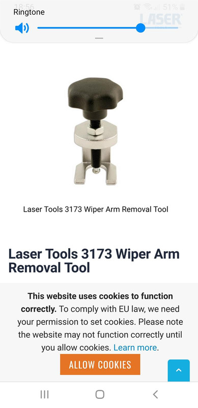

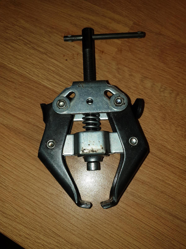

Already have a tool to remove arms but on the mk5 it's a bit big and can't get the angle
As any one tried these or any other that worked

I had my windscreen replaced because of a crack. I didn’t notice at first but the passenger wiper arm was a lot higher up than it should be when in its resting position. I bought that laser tools one and it was crap. Could not apply enough force even with a spanner.
The one that jaffa links to was also crap. It needs about 5mm extra thread. By the tine I managed to get the clamps around the bottom, the silver knob had come off the thread.
Still looking for a better option.
Probably just being useless.

If you' put the wipers in the service position the tool in the first picture works spot on
