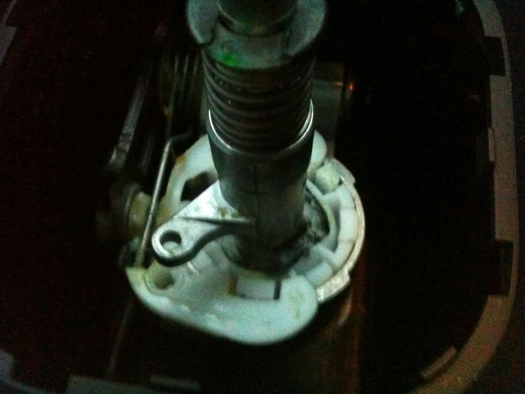

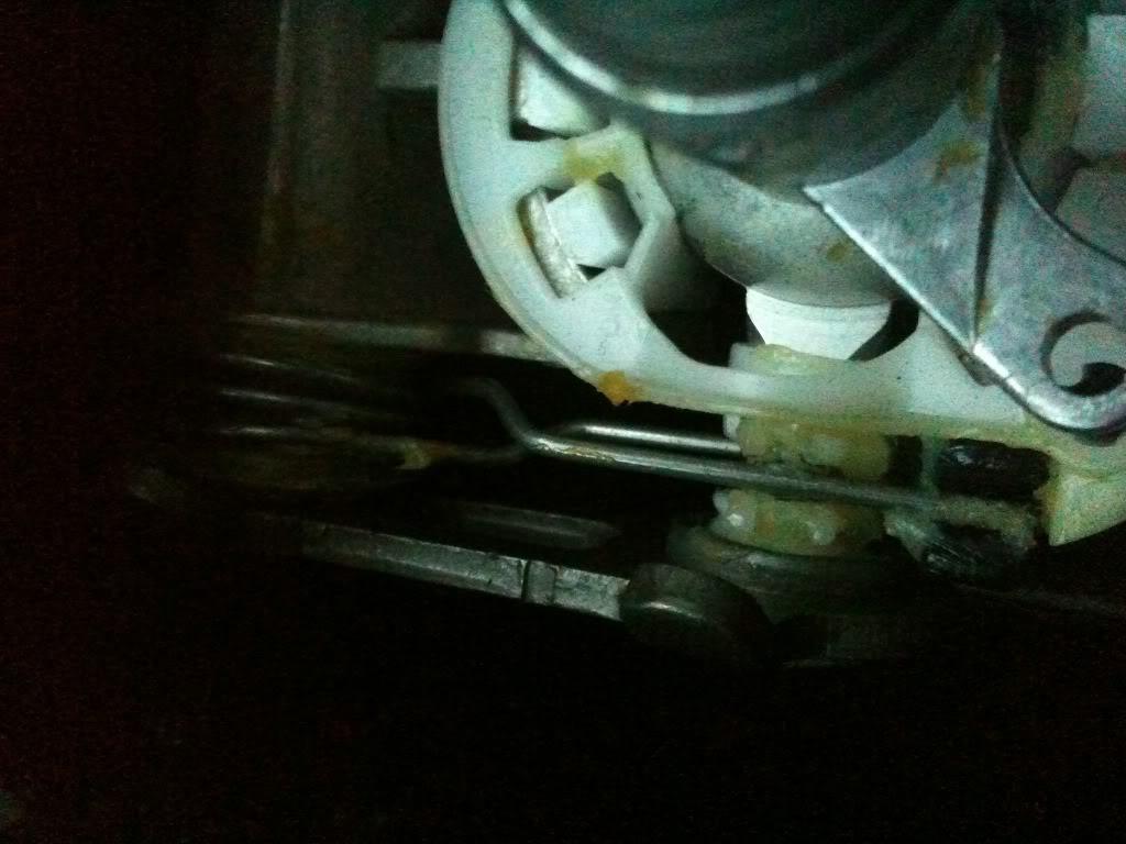

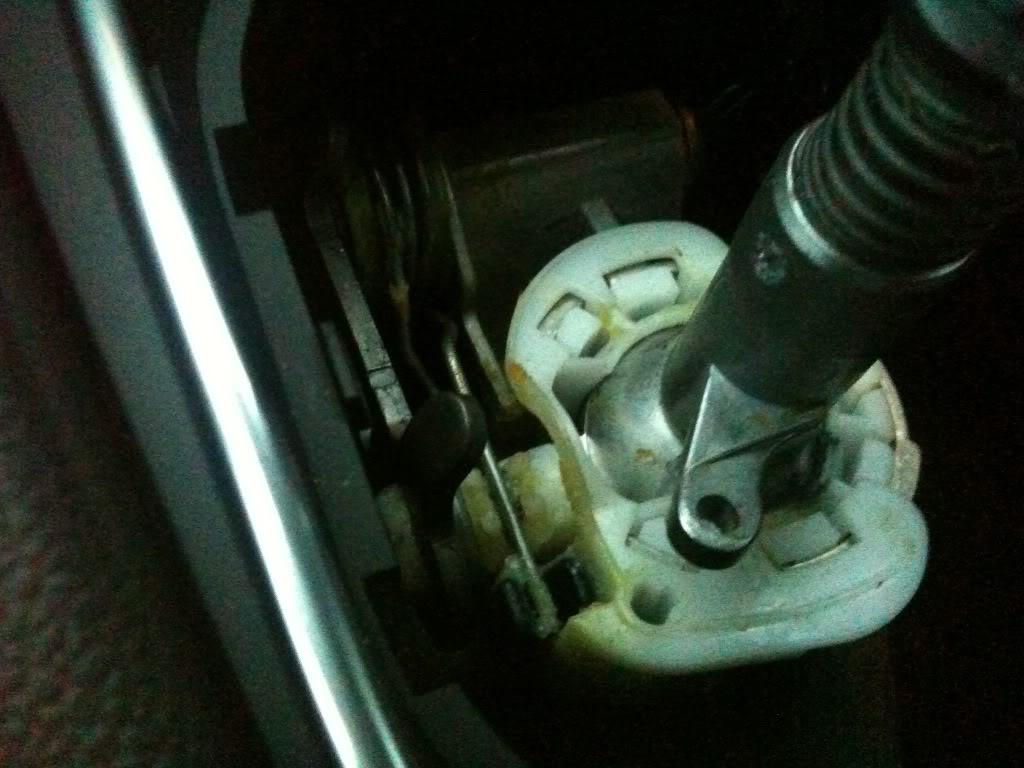

Just after a bit of personal preference on how you reckon this linkage looks:
before I start on the box side of things thought I'd check out the selector as that's were the sound when it sort of jumps about is coming from. The only thing I can think of is that the two pilot holes on the White bush and selector don't line up and I'm sure that's got something to do with the neutral position.
Anyway many thanks chaps if any information can be shed. Luke.

The 2 holes you allude to, are there to put the gear select mechanism in the datum position prior to adjusting the linkage.  you put a bent nail through both holes.
