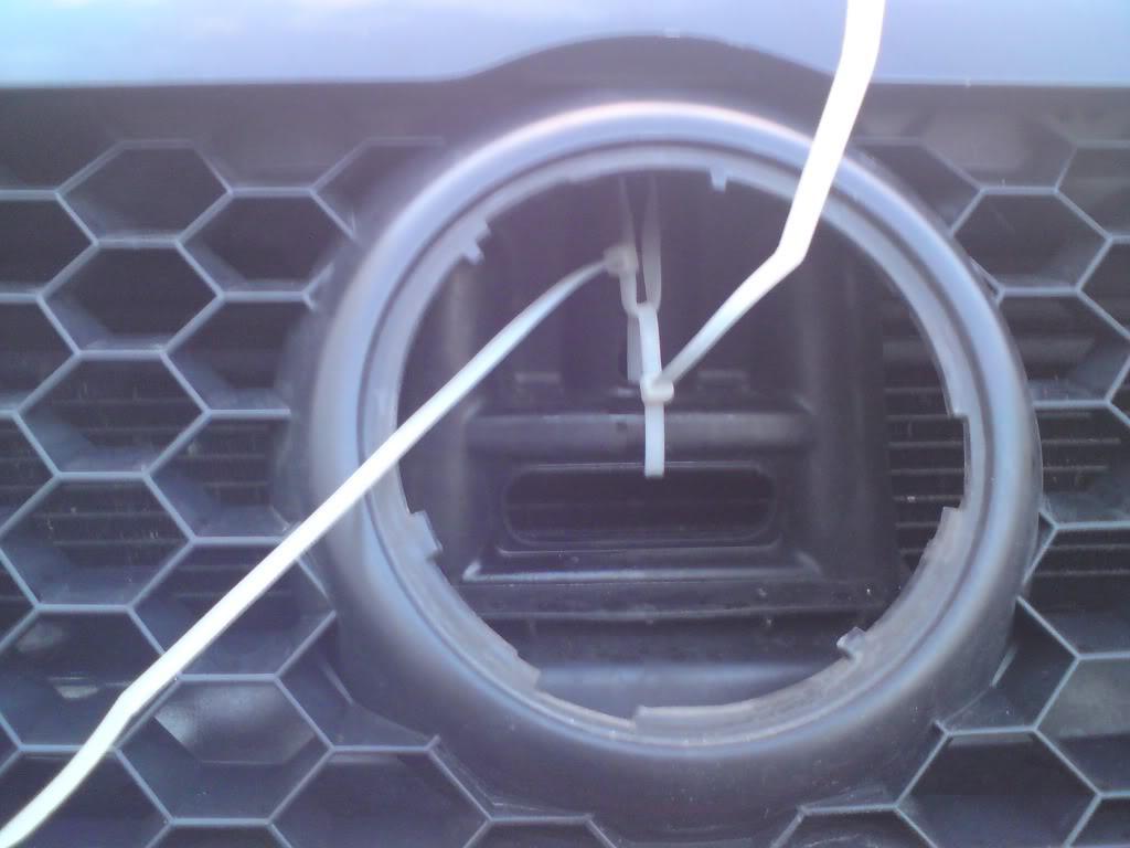

I'm pretty sure its built into the catch mechanism.  I had mine replaced last week as it broke,  bodged it with a couple of cable ties unil i could get it fixed.
