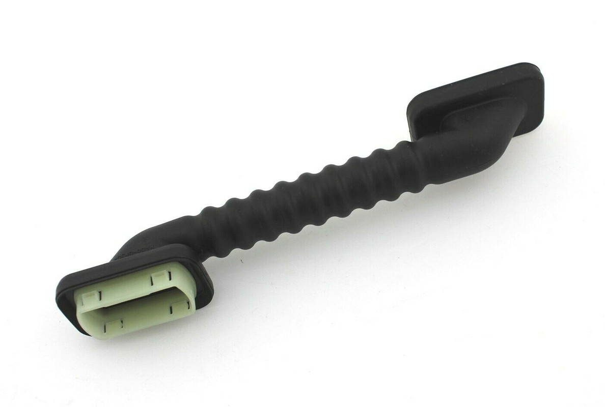

Hi guys,
I suspect I'm getting water in the boot through a potentially perished rubber wiring gator. See below, the closest to looking like what I've got I'm afraid.
I've bought a pair from my local dealership - how easy/hard are they to replace/fit yourself?
Thanks.
