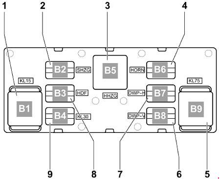

I’ve searched online with mixed results… it seems like an issue with similar VWs that share our platform… the posts I’ve found have exactly the same symptoms and point to relay “433”?

there is a 433 relay behind the cubby box but can't say if the car has more than one...

Turned out to be RELAY B1 under the dashboard (under the steering wheel)
£20 from TPS.
