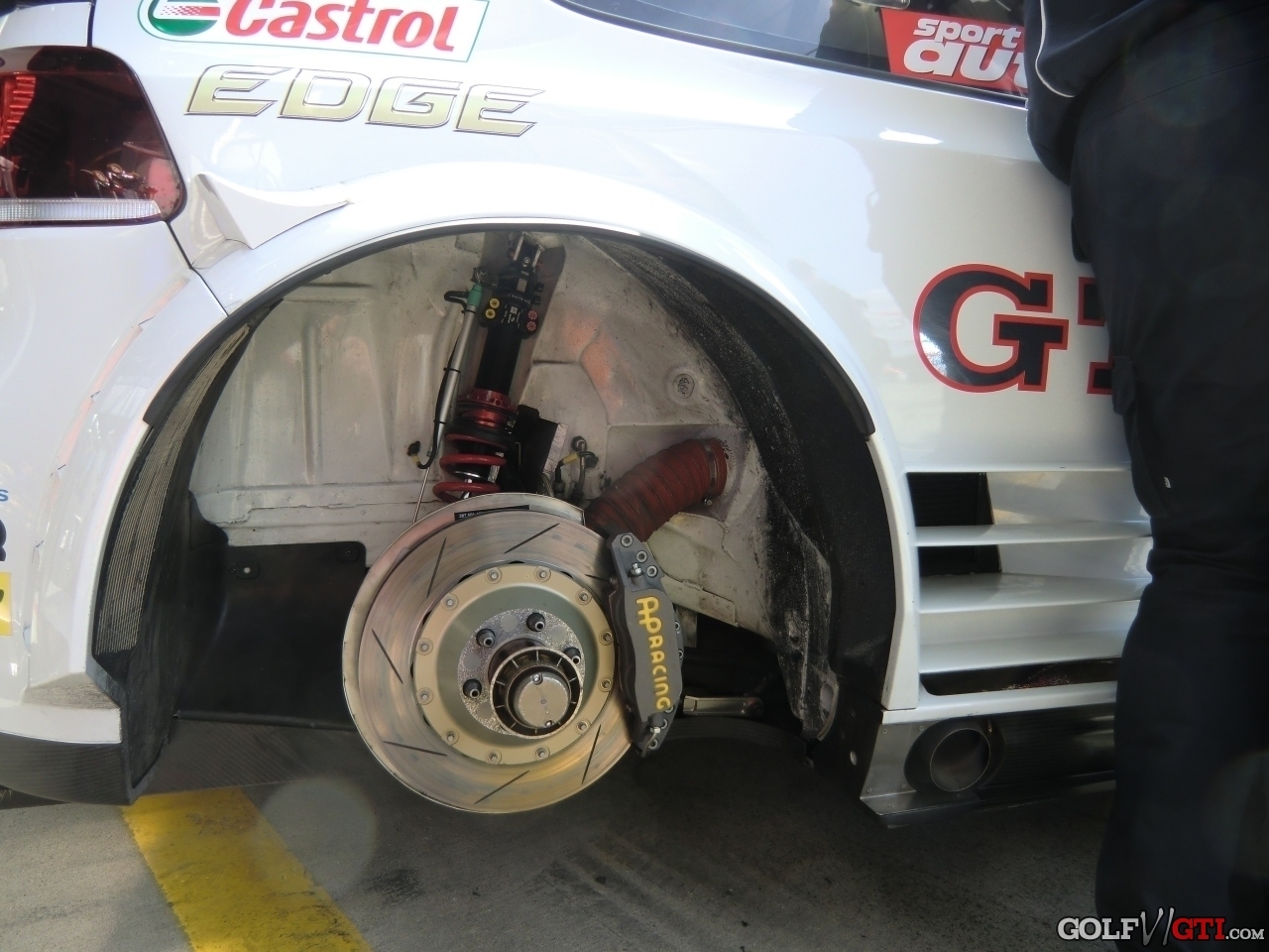

I'd never fit (chinese ?? ) crap like that on this topic to my car.  :fighting:
Racingbrake seems to be better, but I don't trust "open slots" and for this money
there's stuff from much more reputable companies on the market:
That's why I asked for the AP Racing kit.
http://www.apracing.com/products/road_car_upgrades/oe_replacement_disc_kits/strap_drive_kits_and_system.aspx
AP is highly regarded in motorsports. Even Volkswagen motorsport runs AP calipers
and discs (with Endless MA45B pads) on their 24h Nürburgring GTI 2.5 TFSI race car:
"You get what you pay for."
