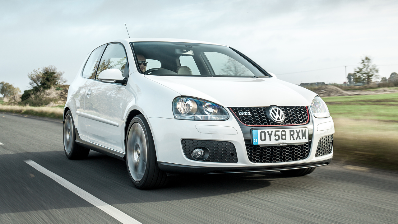

Im looking to swap out my standard mk5 tdi bumper with a golf GTI bumper. Has anyone got any experience doing this?
Would something like this work fine or would i be worth finding a genuine one.

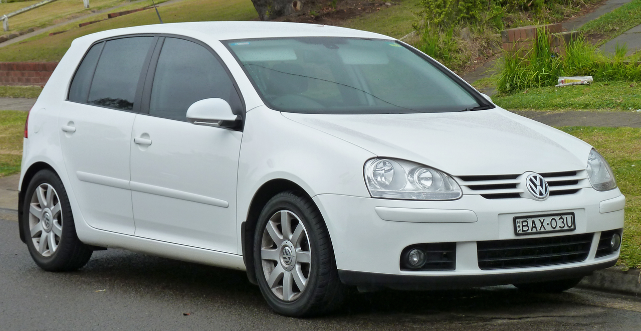

I know this is way too late and would be interested to know if you completed this mod? I just changed out to a gti front bumper on My mk5 golf fsi 1.6 today. Was certainly not a straight fit and required cutting and finessing to get it to fit.

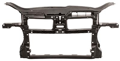

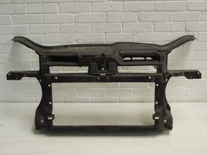

GTI, GTD and Jetta share the same front mount, standard golfs use a different one. To get the bumper to fit perfectly without cutting anything, you need the correct radiator mount. The same crush bumper fits both but you need the correct size X plate to be able to bolt it to the hood latch area.
Regular golf front bumper and radiator mount
GTI, GTD, Jetta front bumper and radiator support
