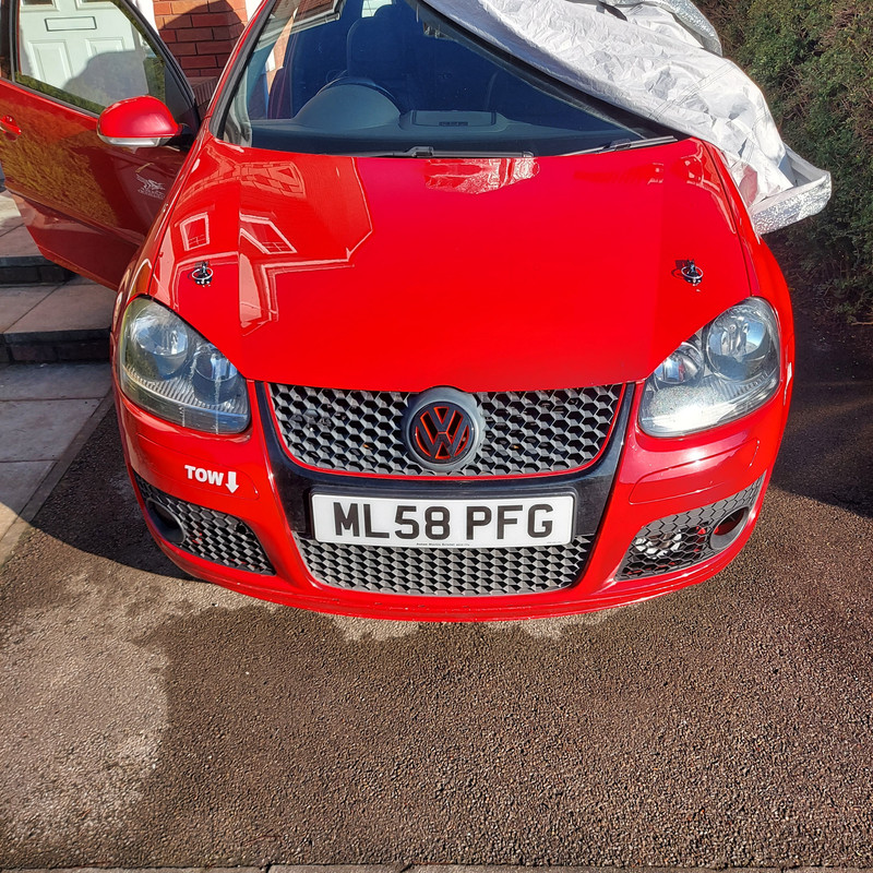

« Reply #84 on: January 16, 2022, 06:20:31 pm »
Great Xmas this year, Mrs car got broken into and took over a week to get sorted and they did such a bad job I had to end up sorting their shoddy work myself anyway and both isolated after catching covid.
Anyway.... swapped the DV out and seems to stop letting go of boost for a 10th of a second randomly as it did before so that's sorted now.
Bonnet pins fitted, tbh I don't like how they look but I prefer them to a smashed windshield and damaged bonnet/a pillars. Aero catches are definitely better but at 10 quid thought I'd give them a go.
Been keeping an eye on the golf over last few weeks and finished all my jobs pre r tech appointment so she's supporting her own weight for a change and actually being used. Just realised a couple hours ago after popping to a mates house that the rear driver side caliper is siezed and the passenger side i think isn't quite perfect either.
That's an extra 200 odd quid for new trw ones that I could have done without, and got about a week to sort in pitch black after work when I get hold of a new set as I'm away on the weekend. So currently frantically researching my options for the rear calipers, any suggestions feel free to share!
To be honest I'm partly tempted to just cancel or post pone r tech for much later in the year, getting a bit tired of the costs coming out on what is meant to be a budget build, it was only to cure a idling misfire after all, not sure if that does any real engine damage and is worth fixing imminently hmmmm.
