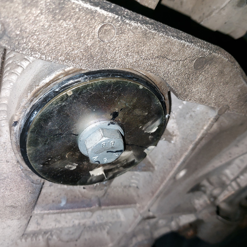

Just been under and looks OK. Roll bar and drop links pass the shake test, everything looks to be attached. Just checked all 3 bolts on dog bone and bolts on the wishbone console and subframe and all still good. After spinning the car around I can definitely confirm it's getting worse, drives fine however just sounds awful.
Now I recall I fitted this and test drove for 10/15 mins and felt fine, stiffer as it should be an no noises. Then parked it up and a few days later tool the front passenger dust shield off for better cooling, put all back together and left it. Next time I drove it started appearing but very rarely. Drove it maybe once or twice and then it went in for its MOT where they mentioned they thought the front passenger top mount was on its way out, I assumed they heard the clunking and just blamed it on that. Also noted was both front shocks were slightly weeping. It really sounds like it's under each the center of the car rather than shocks and top mounts so unsure at this point. Anyone know of some tell tale signs other than it looks f***Ed!

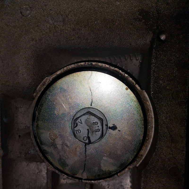

Heres some snaps I took. You can see the lines where I added 90 degrees (maybe just shy but surely not the issue). Note it's 90 degrees from the dot on the washer to the line at the bottom and not the line at the top I'm case anyone thinks I've done it to 180 degrees!
