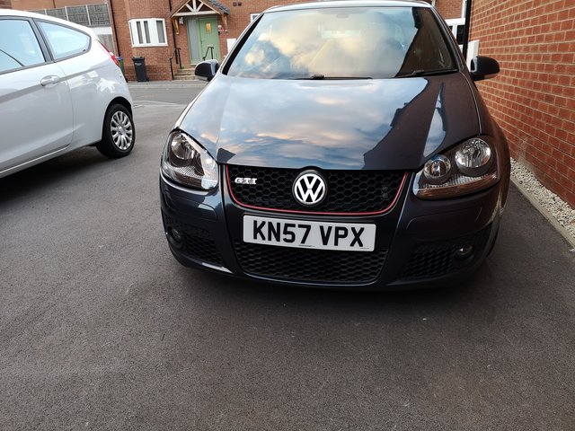

Dark blue mk5 DSG - 150k miles - he's old but has good bodywork and no electrical problems...starts in the cold too! I haven't had him long but he drives well apart from a couple of niggles.
