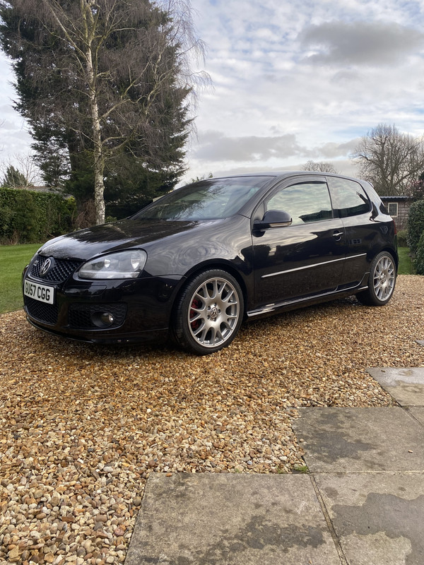

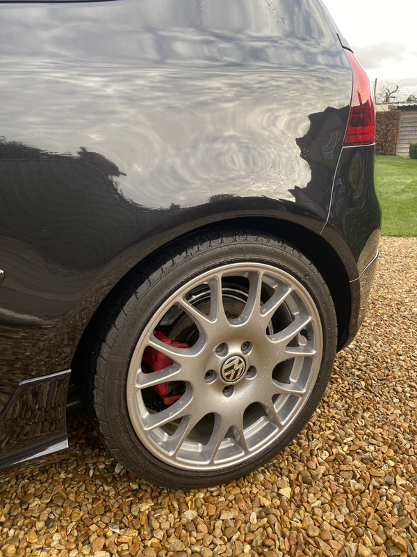

Fitted up H&R lowering springs with the Racingline sport shocks. Will this take time to settle?
See the photos below. Comparing this to others with the H&R springs, theirs seems a lot lower than mine. I can only think that it's the shocks that might be causing it to sit higher currently, or is it my eyes and it is actually sitting correct?
Is anyone able to shed any light on it?
Cheers.

Which H&R springs did you get? Mines on the 30mm and sits a bit lower than yours. Your brand new shocks might give a bit more resitance causing it to sit higher. Did you make sure they are the GTI specific H&R springs not the generic MK5 ones some of the shops also sell?
« Last Edit: January 31, 2022, 09:29:03 am by Bens313 »
Offline pudding
  • -Receive: 692
  • Posts: 8358
Re: Racingline shocks and H&R springs
« Reply #8 on: January 31, 2022, 10:04:27 am »
It won't be the shocks causing it to sit high.  Suspect the springs are the non-GTI ones.

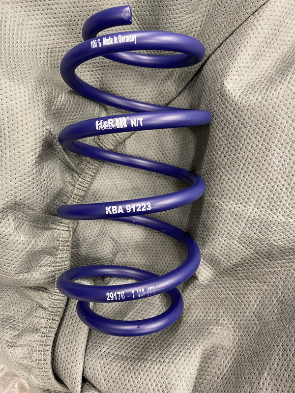

The springs I got are:
H&R KBA 91223
29176 - 1 VA front
29176 HA rear
Are these correct? I have just finished fitting them this weekend gone and driven it once for time reference to the photots.

« Reply #10 on: January 31, 2022, 08:20:28 pm »
Should be the correct ones at least acording to Awesome GTI. The ones i bought have the same part number as yours. Maybe it will settle a bit.

« Reply #11 on: January 31, 2022, 09:04:16 pm »
I think they are correct, I researched it a fair bit on the forums.
I just don't understand why it isn't as low as other cars with the same setup.

Offline pudding
  • -Receive: 692
  • Posts: 8358
« Reply #13 on: February 03, 2022, 01:08:03 pm »
Are you running spacers? Looks like it in the pics. If so then it will look different to cars without. Dunno what the big deal is anyway. Looks fine as it is.

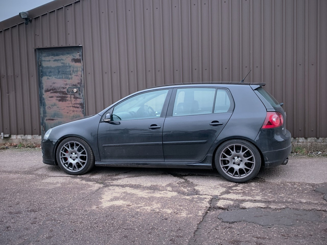

Offline fazgti
  • Newbie
  • Posts: 2
« Reply #14 on: February 03, 2022, 04:16:28 pm »
i have 12mm and 15mm spacers along with Bilsten B4s with 30mm H&Rs and mine is way lower then that.
