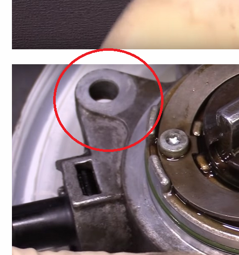

Regarding the broken bit...was it a bolt or is this tab now missing?

That tab

I would say "mostly safe to keep running it until you can get to replacing it.
The obvious is to be attentive to brake feel and any changes.
LOL, and if you need the torque values for any future wrench turning...you can have this;
https://blogvager.files.wordpress.com/2012/01/10-audi_a3_qsb_web.pdf
BPY (in the torque book ↑ ) is North American's version of the BWA. I do not see torque specs for the vacuum pump-to-chain cover. The torque book shows a general guide if not listed. Stating - 6mm bolts have a 10Nm spec. But I have seen it posted the vacuum pump bolt torque is 11Nm;
https://blog.fcpeuro.com/how-to-replace-the-brake-vacuum-pump-volkswagen-mk5-gti-audi-a3-a4-vw-jetta
