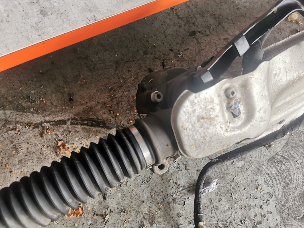

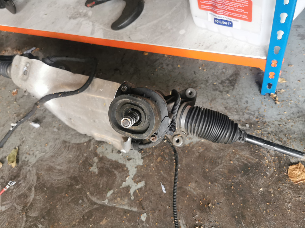

Finally after months my car will be getting thr jobs done whilst I'm away on hols.
The company I've bought this rack from (we deal with them alot) assures me this will fit. It looks to me like a gen 3 rack?

If it is a gen3 rack, I believe it will also need the updated harness.......Pudding did this to his if I recall.

Yeah Gen 3 has 3 mounting holes vs Gen1/2’s 4, which is the visual clue. Gen3 is the one you want anyway. Most rack refurbishers throw 1 & 2s in the bin. They were obsoleted years ago.
Yep, you will need the MK6 harness to go with it. It’s all covered in the gen 3 rack thread in how to guides & troubleshooting.
