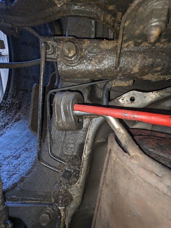

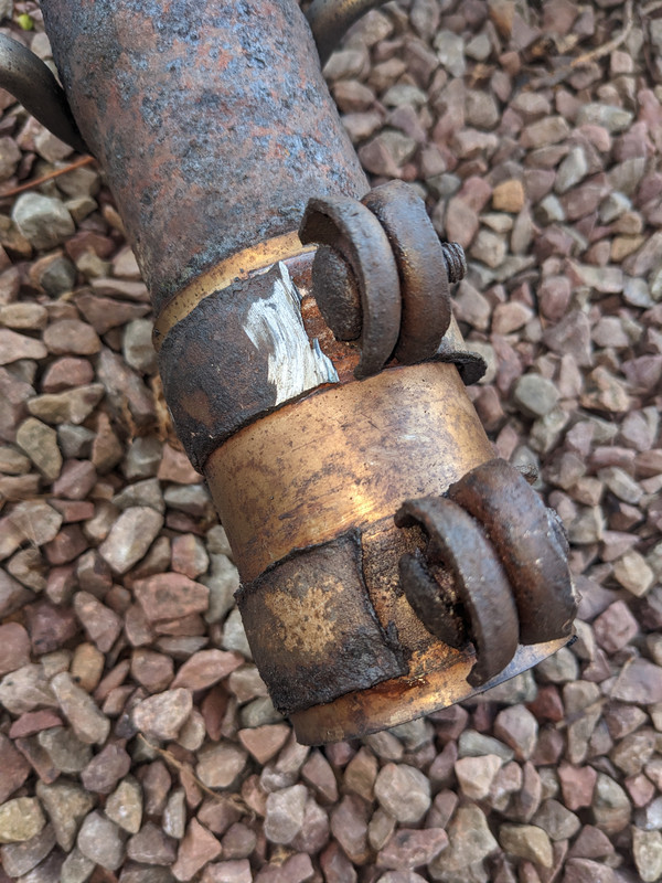

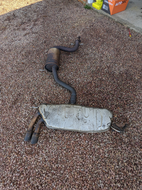

Managed to get the exhaust off.
Wasn't too bad. I rounded off one of the bolts on one of the clips that holds two pieces of pipe together, so I cut it off with an angle grinder. Didn't feel too bad about it because the other clip had rusted in to pieces anyway.
Hardest part was getting the metal hangers out of the rubber holders. But with a trusty flathead screwdriver and a bit of persuasion I managed to get them all out.

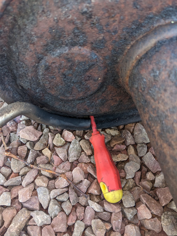

Turns out there is a hole in the center box.

I'm guessing if I go for a new aftermarket exhaust it will come with the right fittings so I wouldn't need to use those broken clips (that were rusted and I angled grinded off)?
