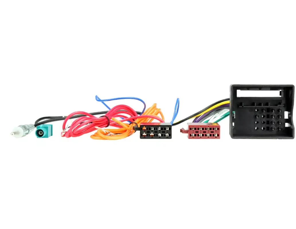

Does this look right? It includes a red cable to a pin that I assume is for connecting to the fuse box.
https://www.halfords.ie/technology/car-audio/stereo-fittings/volkswagen-audi%2Fseat%2Fskoda-iso-harness-adaptor---ct20vw02-581915.html

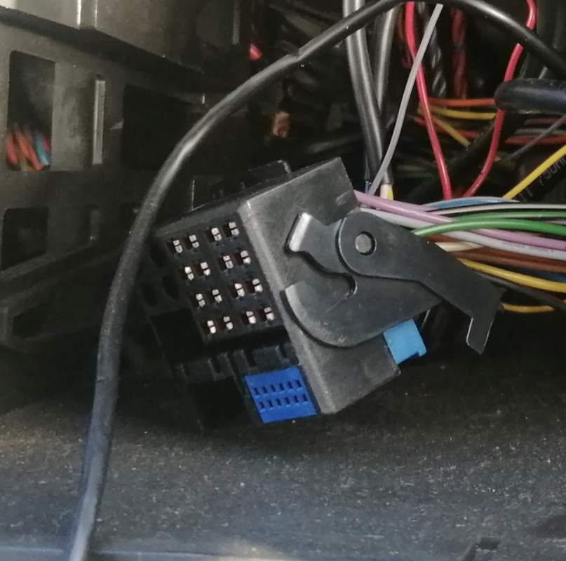

And my quadlock:
Getting a single din adapter and octavia fascia in Ireland is a bit of a nightmare though, so I may just be driving around for a while with a dodgy looking centre console  :grin:

« Reply #3 on: March 23, 2023, 03:53:36 pm »
Looks correct to me

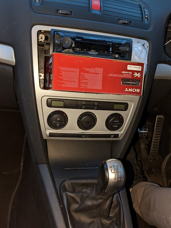

So... I know the forum may hate this install, but I've done an absolute fire-hazard of a DIY job to get it the new head unit installed  :grin: (I haven't managed to find a suitable single din fascia locally yet).
Unfortunately stays on with the ignition off, which was to be expected, as I'm too lazy to actually do the fuse box tap.
Although I did do a amp drain test with a multimeter, and removing the detachable front results in no extra drain. But if left connected, it turns itself back on after a while.
