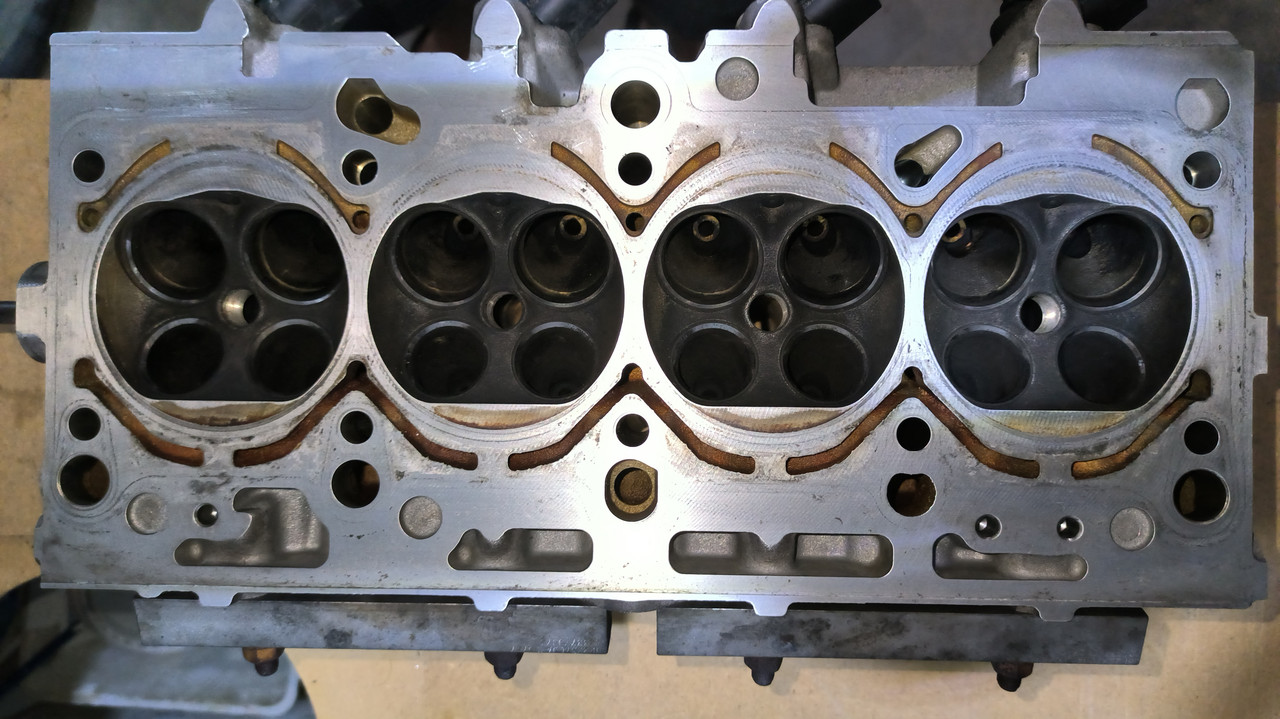

Re: Some Help Broke Down :(
« Reply #76 on: September 27, 2023, 06:59:57 pm »

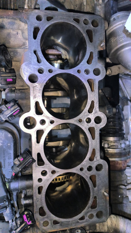

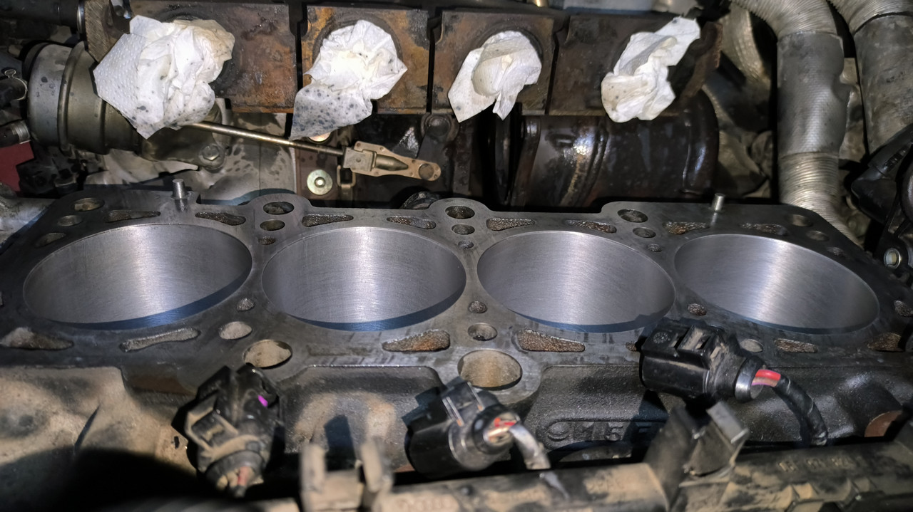

Did a bit more scraping. Are these mating surfaces clean enough?
Did one pass with the honing tool. Hopefully this Is ok  :scared:
05 | Tornado Red | DSG

Just get a Victor Reinz head bolt kit & Head gasket set.
Timing belt, VW change supplier like shirts - get a kit from continental/gates/Dayco/INA all have been OEM suppliers, whatever kit comes cheapest with water pump

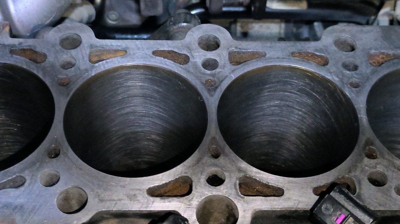

« Reply #78 on: September 30, 2023, 08:04:21 pm »

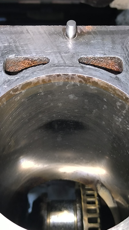

Had another go at the bores with a different honing tool.
Much happier now.
« Reply #79 on: September 30, 2023, 11:24:58 pm »
Looking good  :happy2:

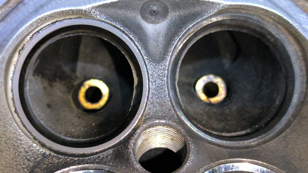

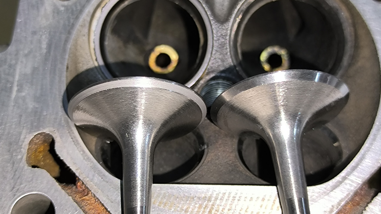

Started lapping the valves.

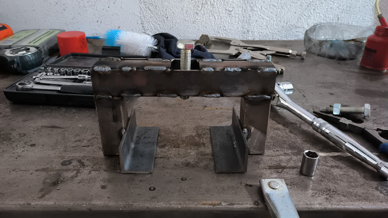

« Reply #81 on: October 22, 2023, 11:17:58 am »

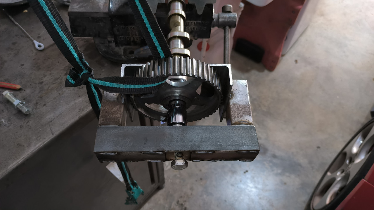

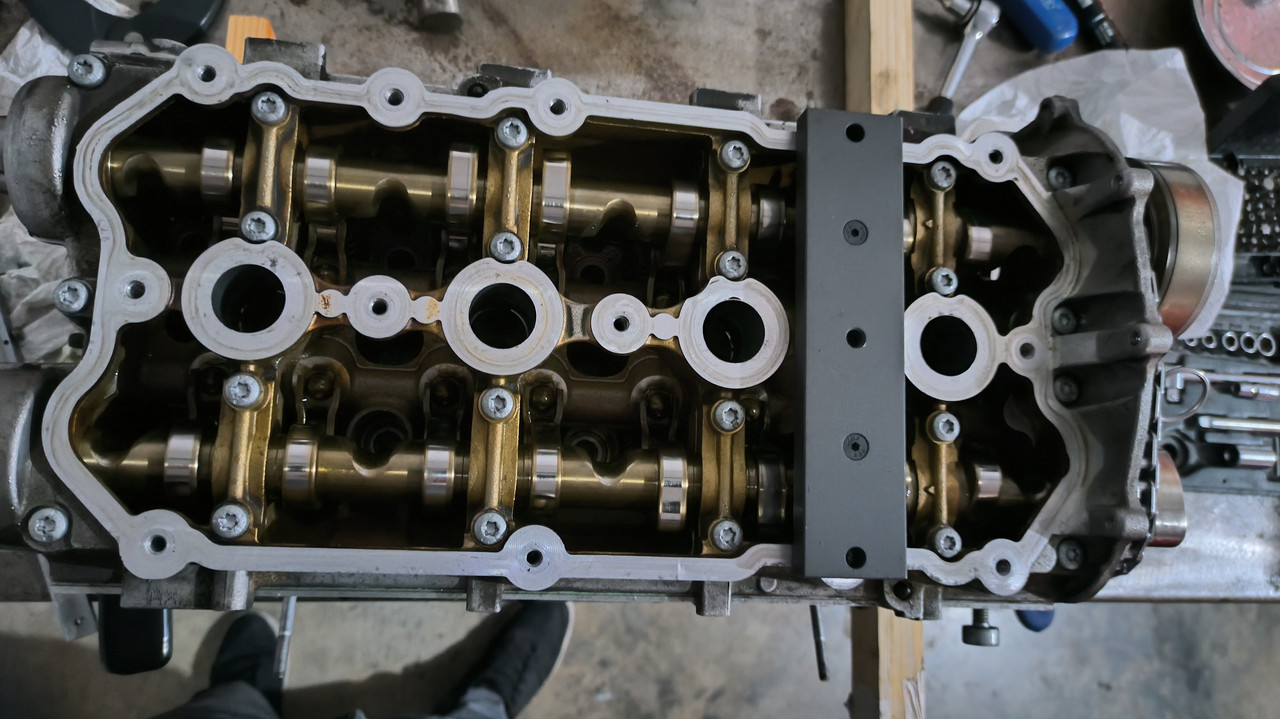

Made a tool to remove the exhaust cam sprocket.
Hopefully next week all the parts will arrive

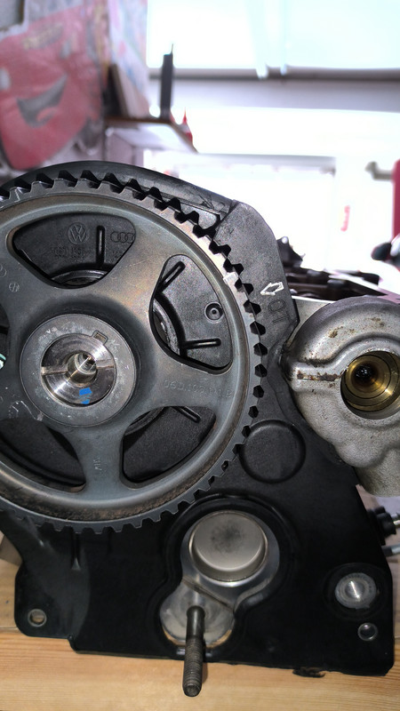

Offline skkane
  • Posts: 115
« Reply #82 on: October 27, 2023, 08:41:35 am »
Set it like that myself. Hopefully timing will be correct when we start it up and check with vcds.

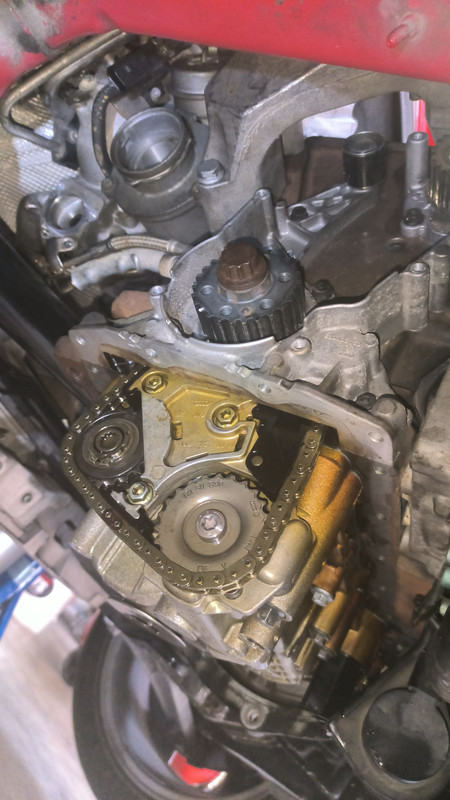

« Reply #83 on: October 27, 2023, 11:05:52 am »
Something is wrong I cannot get the exhaust cam to tdc mark it will spring forward of back and not stay on it.
Offline GVK
  • -Receive: 76
  • Posts: 959
    • GVKmotorsport
« Reply #84 on: October 27, 2023, 01:50:42 pm »
I have heard of that happening on the 2.0 TDI motors, but not the TFSI.
Offline RBS
  • -Receive: 49
  • Posts: 529
« Reply #85 on: October 28, 2023, 12:42:40 am »
Just red the whole story…😱 but…
You’re on the right track  :happy2:
Now what I can See on your head…is your intake cam mounted correctly??
The cam locking tool must go in between the spares from the cams… I don’t see the openings in the intake cam?? Or am I wrong??

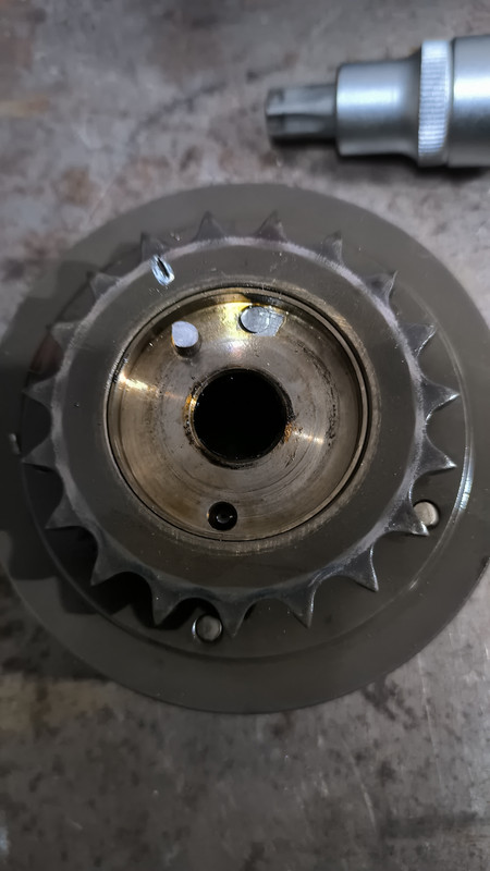

« Reply #86 on: October 28, 2023, 07:17:34 pm »

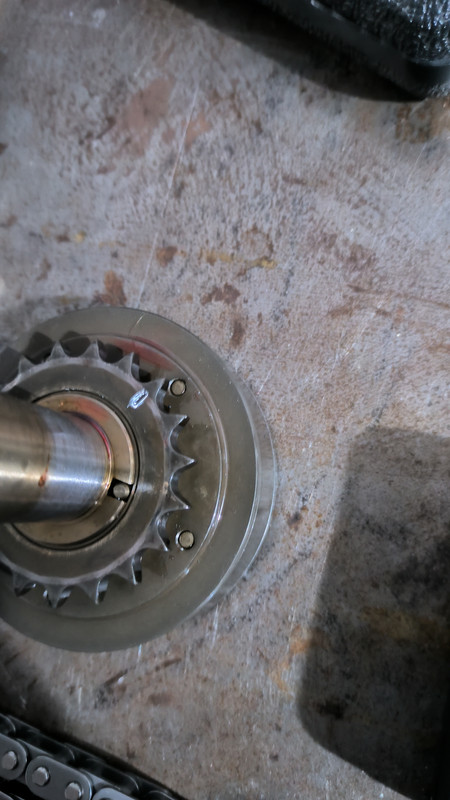

 :scared1: I marked the chain correctly but put it one the wrong way round.
I still can't get it to stay at tdc it spins forward or backwards?
Going to buy some new bolts on Monday.

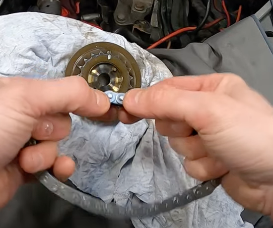

« Reply #87 on: October 29, 2023, 07:36:22 pm »
My adjuster is  sitting two teeth furter out. If i take off will it go back to normal?
from video i followed
Mine
« Last Edit: October 30, 2023, 06:42:20 am by dazza »
« Reply #88 on: October 31, 2023, 06:47:13 pm »
Mystery solved  :sick:

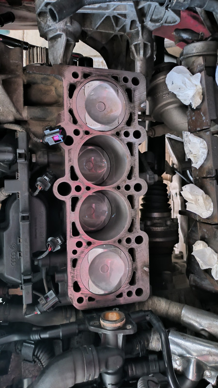

Pistons are in
