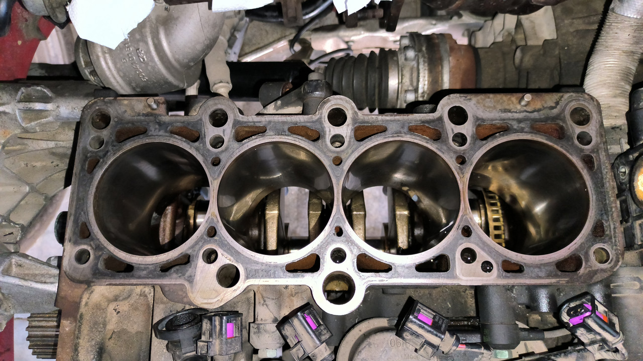

Valves are out what should I be looking for here?
Those my friend are pistons.

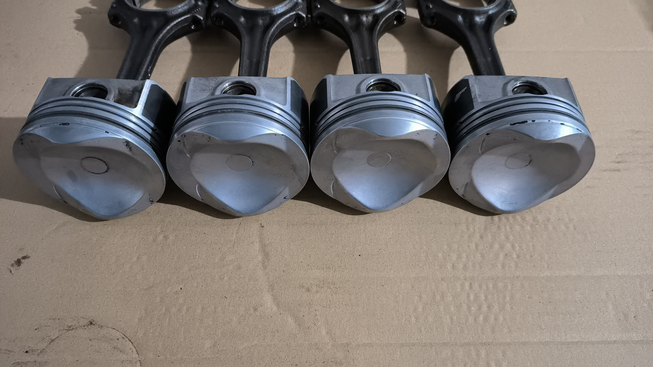

Do the rings spin freely by hand? If no they could have been squashed when the valve/piston contact occured.
Yes they all spin easily by hand.
Any damage to the ring lands (the gaps and part of the piston around the rings)
Not that i can see but going to clean them up tomorrow.
Now is the time to fit new rings and hone the cylinders.Especially if had high oil consumption.

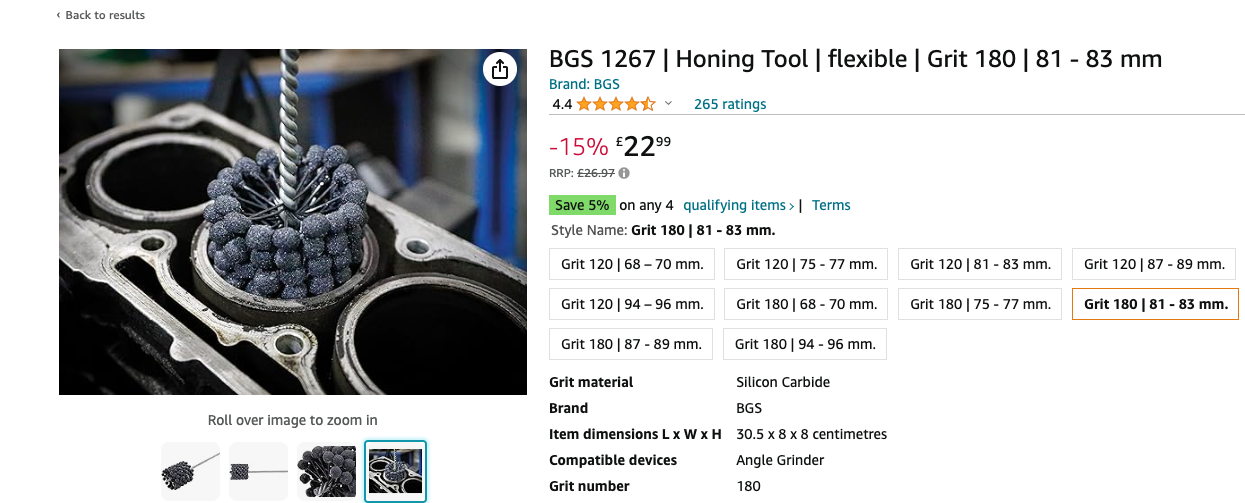

Regardind the honeing is there a resonably priced tool i can buy to diy this?
This has the highest reviews of what amazon has to offer
https://www.amazon.co.uk/BGS-1265-Honing-Tool-flexible/dp/B07XZS9Y1D/ref=sr_1_8?crid=6PB0G9DVIE7L&keywords=honing%2Btool&qid=1695419927&s=diy&sprefix=honing%2Btool%2Cdiy%2C93&sr=1-8&th=1

I've never used that type myself, the garage ones I've used are the 3 x stone type. Can get them for under £20 off eBay I've seen.
Both types will do the job.

To do the honing do i need to take the crankshaft out? There are also the oil feed at the bottom of the cylinders

Just got to be careful at the bottom of the stroke not to hit the crank and oil squirters. The squirters can be removed , see Ollievrs thread about his oil pump woes.

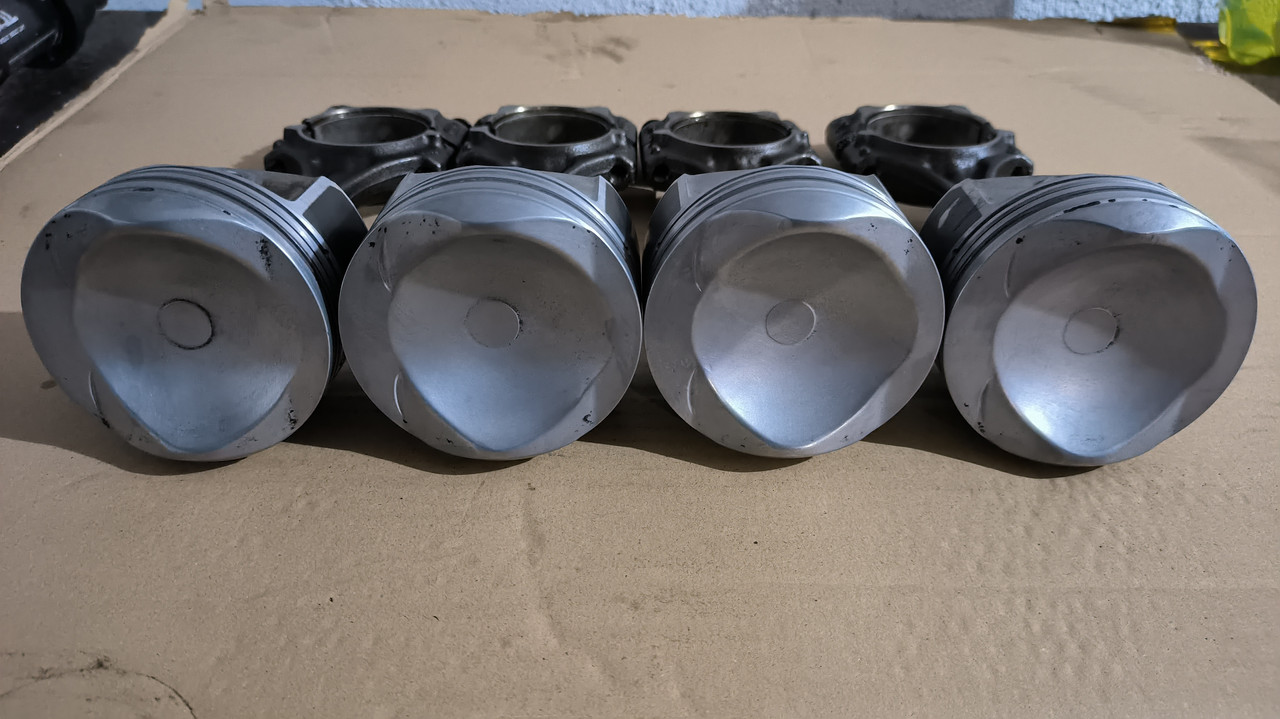

Cleaned the pistons up today.
