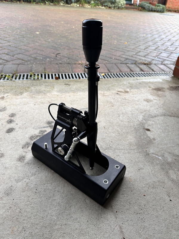

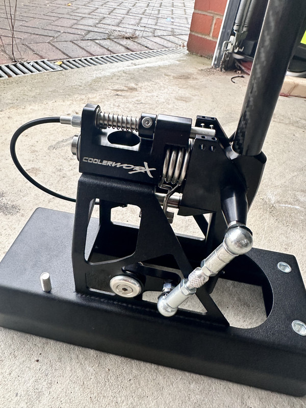

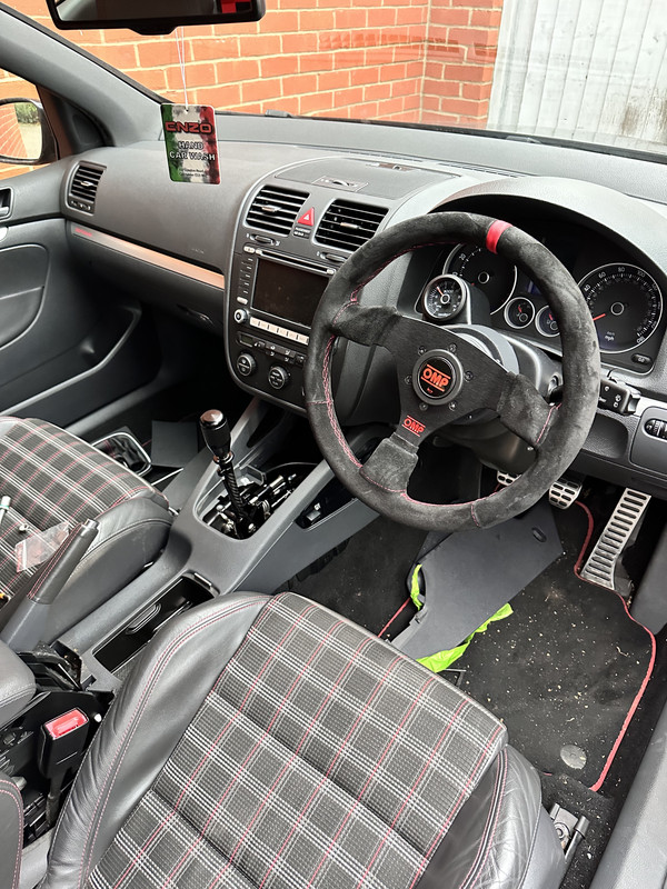

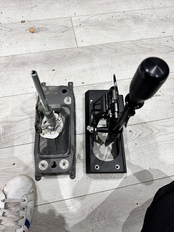

Not a pleasant job, I'm half way into the job. Hopefully tomorrow I can finish and get a test drive 🤩

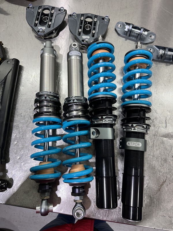

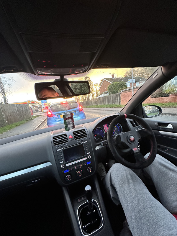

Ordered the Area motorsport package with nitron and hardrace handling bits, including the verkline front arms 🤩... Excited to say the least. The Coolerworx is in and works a charm, would recommend highly. Watch this space for an installation date from Area Motorsport  :jumping:

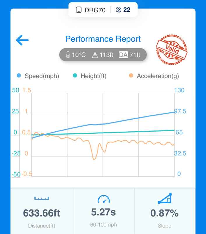

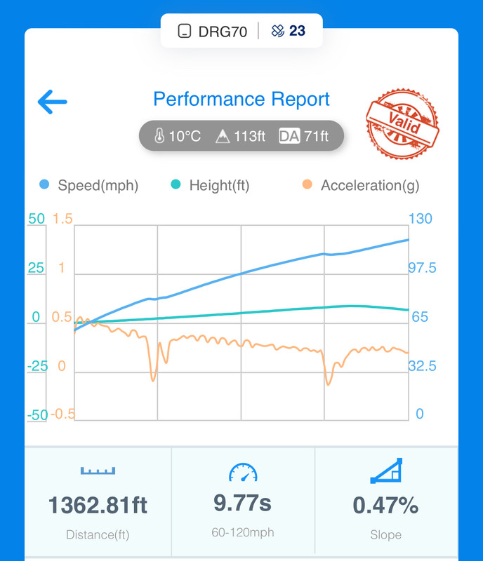

Been out today on a closed runway with the draggy 😬🎉🏎💨... Absolutely impressed by the numbers... Had one run only so there might be more to be had.. Very fast to 100mph and a respectable 9.77 60mph to 120mph.. Happy with the results 🤩

Very good dyno numbers  :laugh:  What does 'Valid' in Draggy mean? I guess it uses GPS and the phone's motion sensor?  Been meaning to get Draggy to see if I'm getting the claimed numbers from my Bimmer, but never got around to it.  My ED30 made 440lbft when messing around on the dyno with my tuner, but we dialled it back as it was just unusable on the road  :grin:

Draggy is small gps unit that measures 30 times in a second and has been used for years in drag racing etc... They have now developed lap timer which I was interested in for track days... The validity of the run is dictated by slope... So if it exceeds 2 % it's invalid due to the car benefiting from downward movement.

Cheers for the draggy explanation, makes sense  :happy2:

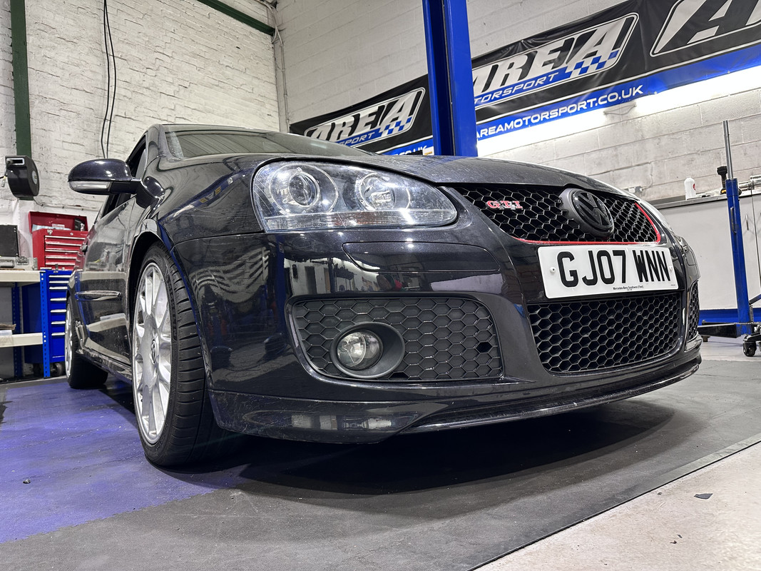

Driving up to Area Motorsport on Monday for the suspension upgrade...I'm excited and got Snetterton booked for the 4th with these tyres.

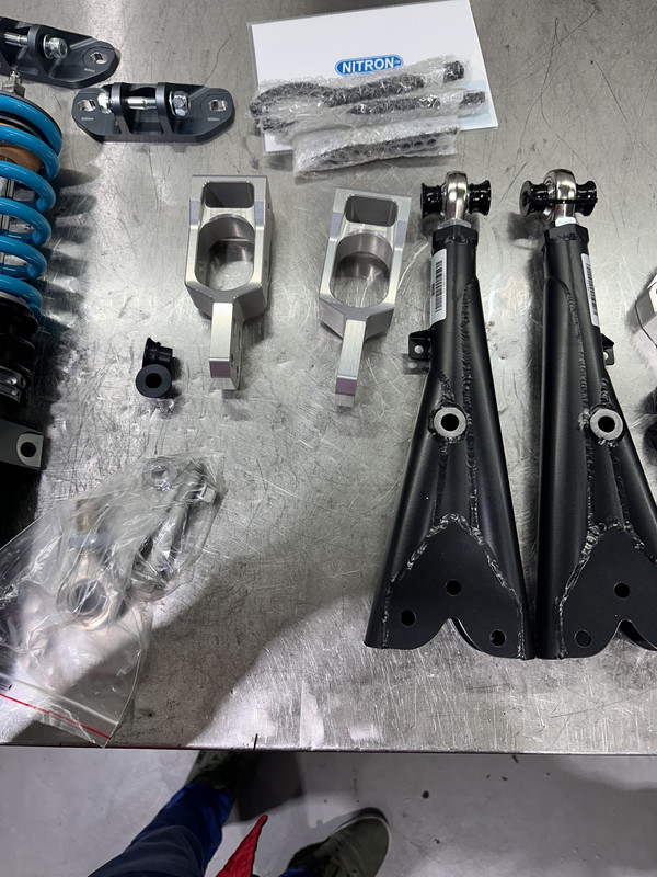

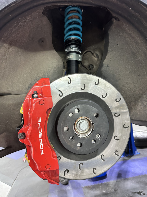

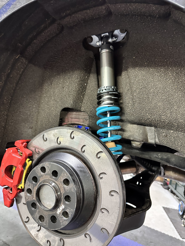

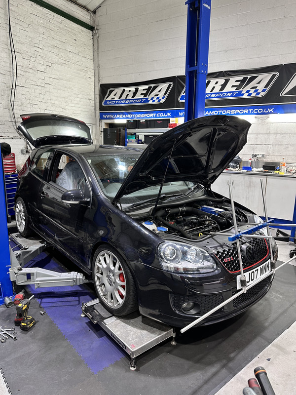

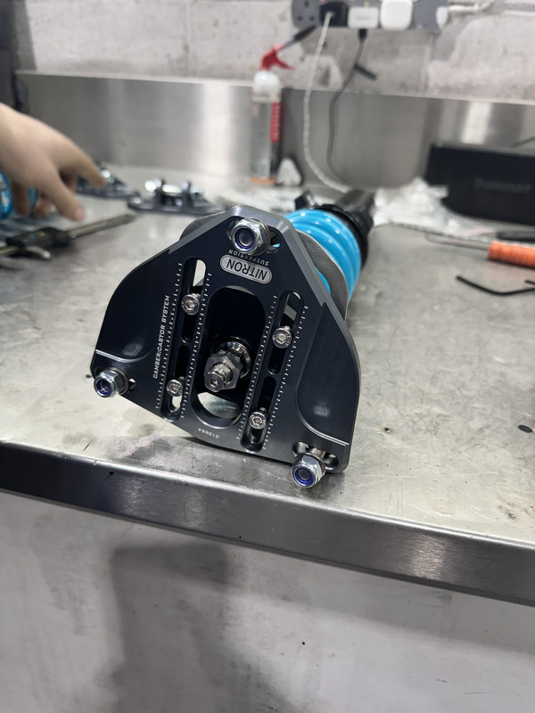

Trip to area was long but definitely worth it... Chaps there are amazing and very knowledgeable regarding the black art of suspension... Arrived there and the table was full of goodies. The suspension got fitted and camber and toe adjusted to a safe setup for me to take on track and report back... Nitron have been setup to 16 out of 32 clicks which is their suggestion for track use... I've left it as is for now and it is definitely on the harsh side when doing less than 30 mph... Once you pass that the suspension starts to shine and the handling is sublime... Downsides for me so far is cabin noise when hitting bumps due to mounts transmitting the noise on to the chassis... The handling so far is night and day... Sharper turn in, more stable, better traction... Here comes the bad bit... The Verkline arms didn't fit due to the caliper and disc offset from the 18oz brembos... So I will have to get ap racing ones and sell these together with the suspension.
I'll be fitting these at the end of February, undecided on 330mm vs 362mm kit.. Anyone any thoughts? Guys at area are running the 362mm brakes on the race cars with great success but I'm not going to do racing so I'm thinking the 330mm will be lighter and offer good braking power?
