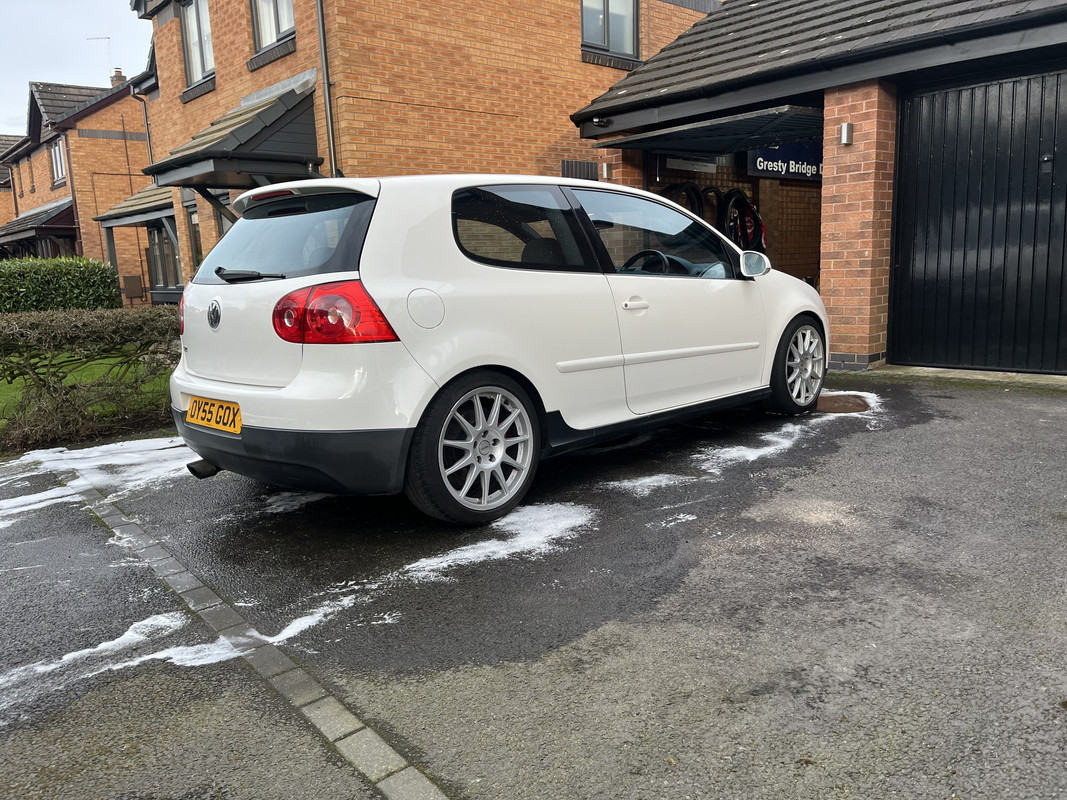

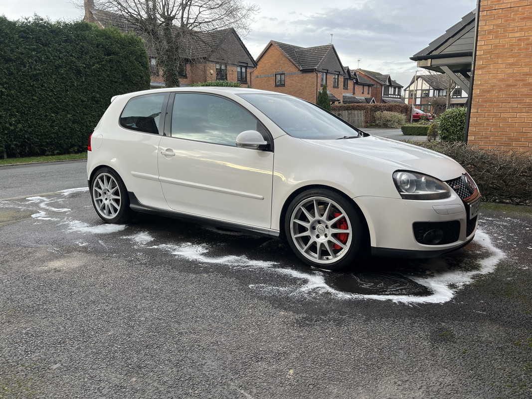

Its back on the road. I had some paternity time over Christmas and new year to do the bulk of it, work has consisted of:
BWA engine from a 2009 TT on 72K, used the turbo and all ancillaries.
BC Coilovers
Speedline wheels 18'
Alloy S3 arms and hubs
Milltek Cat back
ED30 steering wheel and gearknob
s3 intercooler
New rad and condenser
I put a few miles on to make sure all was ok, last week I had done
Cambelt and thermostat
Pick up pipe
Thermostat replace (Was dropping to 70 when driving)
So far so good, with the addition of a RCD330 its incredible just how nice of a car a now 19 year old mk5 really is. I think it has a map on it but its a bit torque steer prone. So probably next winter will consist of a refurbished rear end, k04 swap and some sort of LSD. For now I will enjoy it  :smiley:

Offline RBS
  • -Receive: 47
  • Posts: 480
Re: White mk5 GTI rescue
« Reply #12 on: September 13, 2024, 10:54:42 am »
Looking sweet😍 and like the brakes 😘
