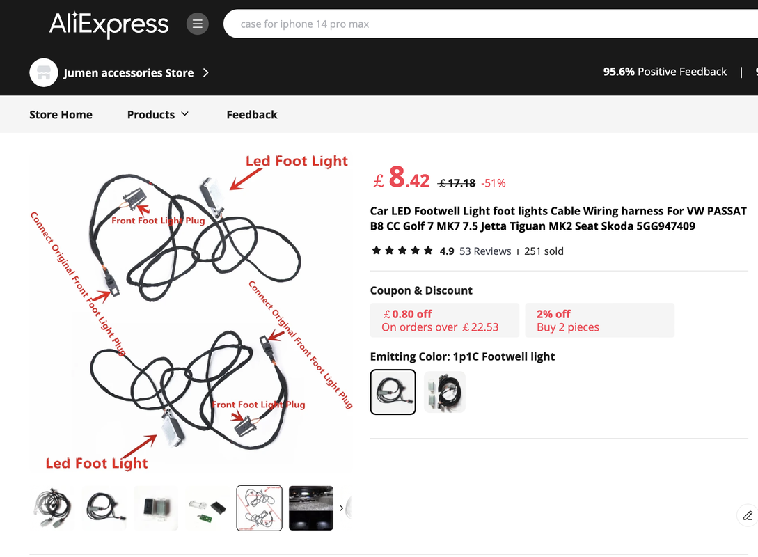

I have a '56 plate GTI with I believe has every option there was available in 2006.....yet it didn't have a footwell light on the driver side! I had an Edition 30 some years ago and that did have both footwell lamps.  I can only think the passenger light is always fitted since the majority of cars produced are LHD.  I bought an Ali Express loom and fitted a Drivers side lamp. Pretty easy job.  Just requires removing the glovebox, connecting to the passenger side lamp, feeding the loom cable to the driver side, popping out the plastic blank in the panel below the steering column and fitting the new lamp and connector together.
Here's a screen grab of a similar kit for the under seat lamps... you get the idea!  The quality is fine and its a nice upgrade.

Ah that really helps!
Thanks for the info and picture. I'll have a look on Aliexpress and get one ordered up!  Looks straightforward enough.  :happy2: It's the small things innit!  Lol!
