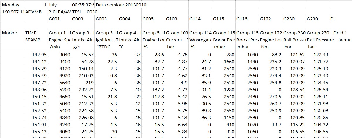

Ever since I first mapped the car I felt like it always pulled better after it just got up to operating temperature compared to how it pulled after driving around for a bit. Well today I decided to log it again but this time included intake temps as well. surprise-surprise, it's not looking good. I guess that's what happens when you did a K04 swap, kept the stock intercooler and haven't yet replaced your leaking AC radiator that's bent up like hell.

Both of these logs come from the same pull. I went on the highway, made the first pull on the on ramp and the second after driving to a U-turn area that's 5km from the on/off ramp.
Ambient temp was 23 degrees here
Ambient temp was 20 degrees here

The ECU doesn't start pulling timing until intake temps hit 45 C, so your readings aren't too bad to be honest.
