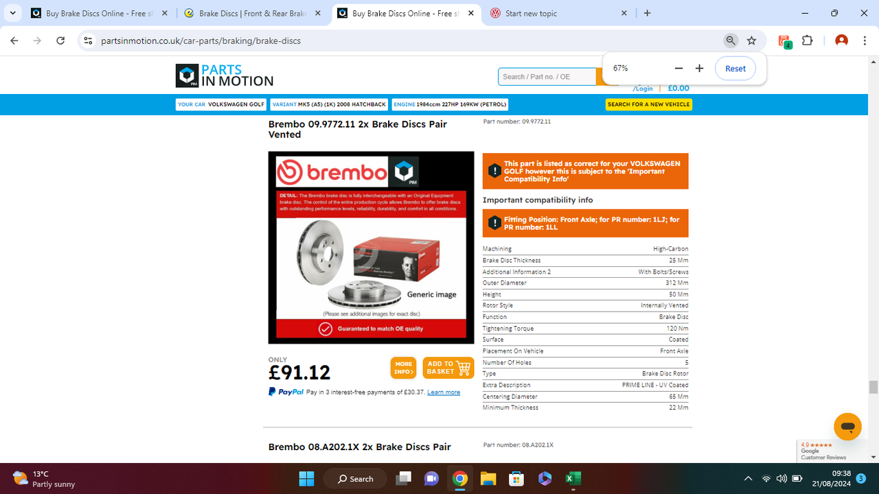

Hey everyone. Looking at changing my front discs and pads - not done this before. On partsinmotion.co.uk they have got a bunch of different Brembo discs available - is this the pair I want...

Depends on the car you have, but assume the pic details are correct and you have an ED30
312mm vented is the standard GTI/ED30 front, but many upgrade to 345mm brakes from the R32/S3 etc
A photo of your front caliper can confirm this

Sorry yeah I've got a Pirelli GTI.
Assuming if you upgrade the disc size you have to change the caliper too?

Yes. The caliper is a lot bigger on the R32/S3.
The rears of the R32/S3 are pretty much the same size as the standard GTI/ED30/Pirelli fronts @ 310mm
If unsure just measure the front disc diameter roughly.
312mm standard fit brakes
