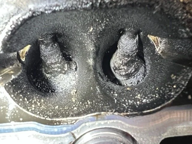

Direct injection petrol like our TFSI is the worst for carbon fouling.....loads of info about it
It can cause misfires like mine had where the carbon stops the valves sealing..........and also a total loss of top end power like my wifes golf had, where the valves were like ice cream cones, but sealing and no misfires.....zapping the power

My wifes was similar to this on an FSI MK5 Golf
My TFSI GTI was a little less but the carbon was not allowing the valves to seal creating misfires.

So it's most probable that my problem is carbon build up? The injectors are dirty and are not feeding the engine with enough fuel?
Is a carbon clean expensive? Would I have to change the injectors too? Is there a way of knowing that there is carbon build up before taking the inlet manifold off?
It is time consuming and took me a day at home to dismantle and clean out the carbon while the injector tips were soaking in petrol.
New injector seals are about £100 for genuine ones
New manifold gasket about £20
A variety of picks and wire brushes etc
General tools to take the manifold off
Time
If not the cause, it will def help make the engine run a lot better.
