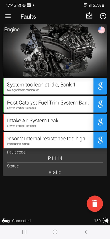

Update:
Took it to the garage for a smoke test and they found that a screw was missing from the MAF sensor (should really have spotted this myself!) and a blanking cap was missing from the vacuum line. This was sorted and a second smoke test showed no leaks however 2 days later the code is back along with others.
Does anyone have any ideas of what I could do next to check what is causing this? I’m going to take it back to the garage to get their opinion but don’t want to start throwing money replacing DV, PCV, MAF sensor etc if there is a way of narrowing it down.
I have obdeleven if that helps with any diagnosis.

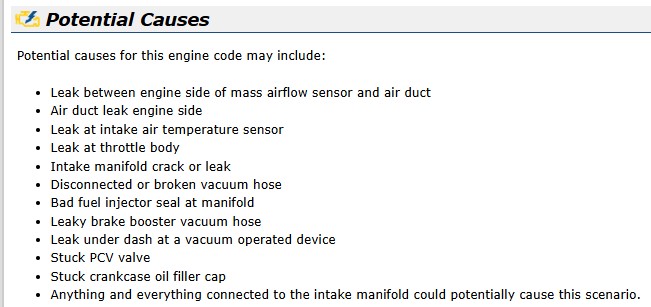

Sounds like PCV to me as pulling the dip stick out would make the car almost stall and hate that it was even turned on.
Was it an original PCV as I once used an aftermarket one that failed within a year, put an original on and its been fine for much much longer since.

The corrugated plastic hoses also crack and become brittle (age and heat cycles).  I replaced both of mine due to cracks that I could not see......the two from the PCV.

You can take it off and blow into it.  Air should be flowing one way and not the other, via the valve.

Pcv sounds fine to me. Pulling the plug, the engine clearly start going rough but it stabilizes itself and increases the rpm. Thats normal. If the pcv was bad, you'd get misfires, running lean codes and the engine would tend to shake at idle, especially after starting.
On the other hand, if there's a vacuum leak, what will happen is the engine will stabilize itself after 2 minutes or so and then if you pull the dipstick or take the oil cap off, it will make no difference. This means there's a constant air leak in the system.
But yeah, if it hasn't been done, it's worth replacing. Another thing that went bad for me was the brake booster vacuum hose. The plastic hose that goes from the check valve to the vacuum pump cracked and created a constant leak.

Hi thanks for the reply. Just got back from the garage and they are saying the second code is pointing towards the lambda sensor (post cat). I think the plan is to replace the PCV, and then do a continuity test on the lambda with a view to possibly replacing that if it is showing as bad. Thing is i had the same lambda issue 2 years ago when i went back to the mapping company to get the map tweaked after fitting a sports cat.  They said the lambda was damaged and they replaced it. A week or so later the code was back. However this code only seemed to appear every 500-1000 miles after clearing, which i put down to the map. The code relating to the vacuum leak won't go away.
They are telling me after the second smoke test there were no leaks showing, so either it is the lambda sensor causing it, or something that wouldn't show in the smoke test (PCV, Diverter valve?) or they have missed something e.g very small leak from a hose - possibly obscured if it was resting on another hose etc.
Very frustrating!
