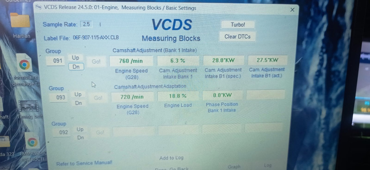

I did the intake valve cleaning myself not long ago (less than 3000 miles).
I checked on VCDS the timing chain spec (operating temp at idle) and it looked good. Heres a picture

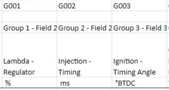

I would also log injection timing, lambda regulator and overall ignition timing. When I checked for timing issues, it turned out to be too much boost, not enough fuel. Crazy high injection timing and lambda correction being maxed out at 25%. I'm running the same boost as you are, on stock k03 injectors lol
