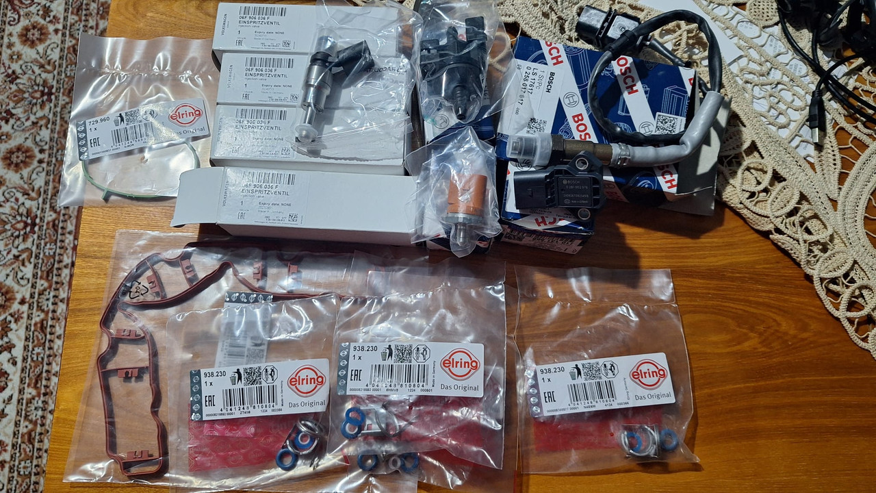

Well took the day off to tackle the fuel injectors. They have been in the back of my mind for a while, as been seeing lots on how the filter baskets start failing and cause running issues.
Bought elring seals, stainless mesh baskets from AKS and I have the injector seal fitting tools already and went for it. I had carbon cleaned the inlet valves about 5 years 20k miles ago and was also curious to see how bad they had become, if at all.....they were really bad the first time I did them.
After striping it all down and removing the inlet manifold, I was surprised as to how much carbon had built up again....but not as much as when I first did it.
Injectors were dirty so soaked and cleaned with a tooth brush the heads
Removed the baskets which were also dirty and falling apart. Caught them just in time.
Cleaned the inlet valves to about a 90% clean state....after and before.
Flushed the injectors out using a can of carb cleaner connected to its pipe and then into a tyre valve. Used a 9v battery to cycle the injector on and off until a fine mist was produced.
New seals fitted to injectors and manifold
Put it all back together, primed a couple of times and she fired straight up..... thank the lord LOL
All good and no leaks, but will monitor how she drives and cold starts.

The special tool kit (made by Laser in my case) for the injector seals and removing the injectors make it very easy, but people have improvised tools out of pen lids etc..........your choice, but I invested in the tools 5 years ago when I decided to do it the first time, as I did not want to mess the seals on the injector tips.  They need to be stretched, fitted and then compressed in stages for a perfect fit.
It took about 5 to 6 hours to take it all apart, clean injector heads, remove and fit upgraded baskets, flush injectors, fit new seals, and then refit everything so the car is back to normal........not rushing and taking pics etc.
This is the kit I have for the injectors:
https://www.lasertools.co.uk/Product/5069/Injector-Removal-Kit-for-VAG
and also bought a basket removal tool like this one
https://www.efihardware.com/products/2698/Fuel-Injector-Filter-Basket-Removal-Tool
and four of these upgraded injector baskets
https://www.akstuning.co.uk/shop/home/2669-aks-ea113-tfsi-fuel-injector-steel-filter-basket-k034basket.html
