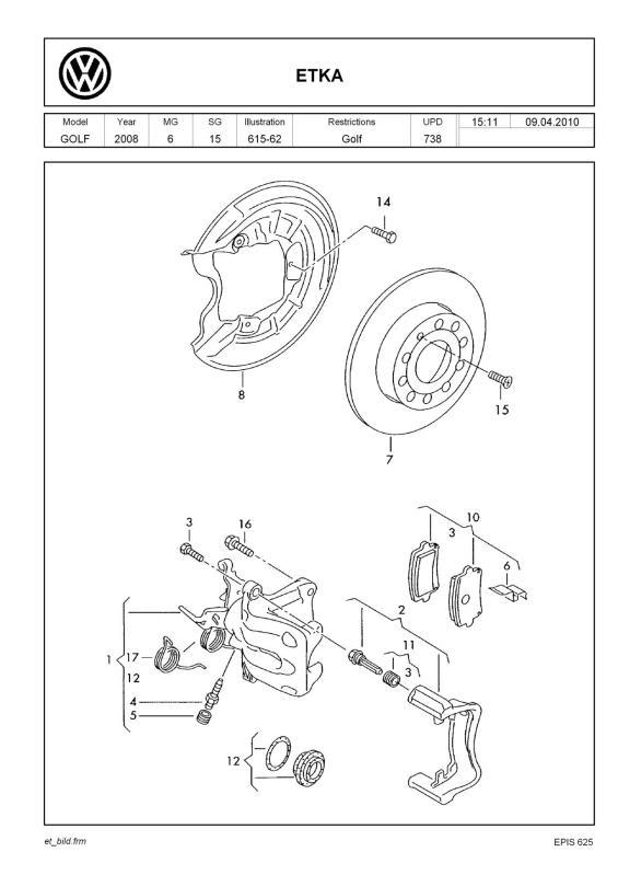

« Reply #27 on: April 09, 2010, 03:14:27 pm »
Splash, Sh!t, stone guards, all stuff to be kept away from the brakes IMO.  VW spent enough time designing it, and ensuring fit for purpose and safe operation.
To refit a set, you will need to cut a part of the shield out, to feed it over the hub.  See the below illustration.
part numbers
1K0 615 611 P - Splash Shield  left
1K0 615 612 P - Splash Shield right
Offline QD MBE

Ps you will have to remove the disc and caliper, not sure about the carrier............
....That's a bummer! I suppose this can be done without undoing the brake lines and having to bleed the brakes?
I assume a S3 or R32 sh!t guard can't be fitted to the GTI.
