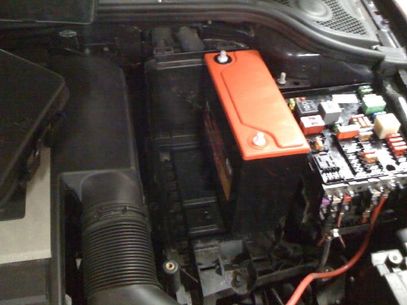

So the slimmer battery option came back in my head. I looked at braille, varley red top, powervamp and odyssey battery. I finally settled on odyssey racing extreme 40 battery simply because I needed a battery which was 97mm wide or less and had the most power. And as a matter of fact the odyssey battery is really good since its deep cycle and has a 45ah with 87 reserve time and ofcourse 1100 amp 5 sec cranking power, so this is definitely up for the job. Got my installer to fit the battery and he had to cut and remove the original battery tray and surroundings as seen in this pic:
With the battery you need to order the conversion terminals but the ones I received where both negative posts (i machined the negative one to make it fit) but a proper positive terminal is ordered along with battery terminal covers to make things look neat. Make sure you ask the company first that one post is postive and the other negative since most companies are selling both same battery posts (and this is not good.) As a side note the racing battery is not really that light compared to the standard battery, its only 3.5kg lighter (standard battery weights about 16 kg, this one weighs 12.5 kg) but the cars feels more nippy for some reason plus the power delivery is much smoother then before. Gives the feeling as the car is not struggling at all through the revs when the foot is set assured. Might be because this is a racing battery and gives the car a better and faster supply of power but it does feel slightly different (in a good way). I have had no prolems what so ever, starting the car or with the ac/lights not powering properly, everything is fine electrically, which was my biggest fear.

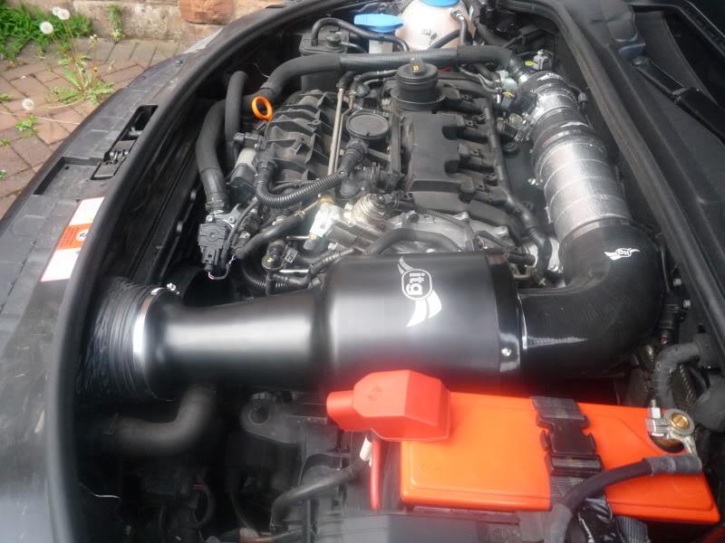

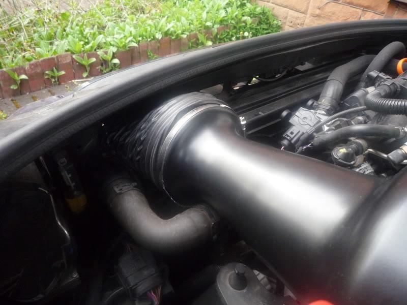

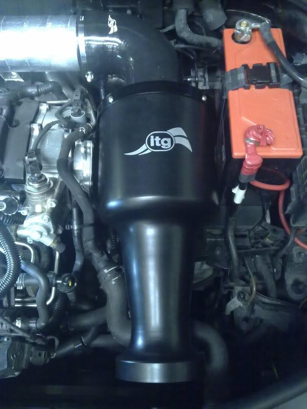

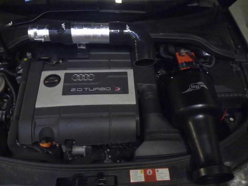

I drove to ITG in coventry from Glasgow and got there at 7AM. I was presented by Andy who is a very nice guy and knows his stuff. He got on with the installation striaght away and told me everything about the kit throughout the process. I wasn't aware but this kit is made with every minor detail in mind and Andy told me why the pipes are curved here, and why the map senor pipe is still the same size and this is what really impressed me, there was even a groove in the turbo intake pipe for better airflow unlike other some kits which have the pipe stretched over. You can see what I mean by looking at this pic:

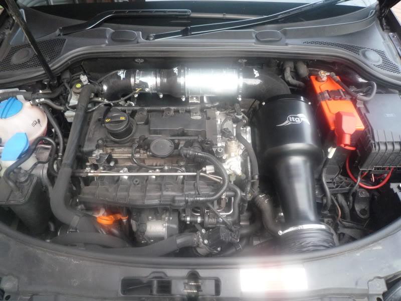

Then I spoke to Andy about the airbox and I tried to tempt him into fitting a carbon fibre box but he insisted that this kit was better suited. The carbon fibre one has the input and output pipes at 90 degrees and requires alot of space too. Then Andy boguht out the airfilter and I bloody sh#t myself looking at this thing . Joke aside this is the biggest induction i've seen and its really light weight too, which I was even more impressed about. So I placed the kit on the engine to show you the sheer size of this kit:
Andy explained that this kit is good for 450 bhp and had a cone area larger then the other ITG kit plus can go upto 550bhp  by getting revised cone filter. He also had the metal areas of the piple taped with heat shield. So Andy set about fitting the kit and the pipes on this kit are 3.5 inchs, absolutely huge. Heres a few pics half way through the install:
You might be wondering there can still be slight heatsoak since there is a gap in the front and speaking to Andy he said this is a fully enclosed airbox (no engine air can get in the induction system) and he said I havent finished yet. He brought out a 5" flexible pipe to fit infront of the airbox and I was gobsmacked with the size of this pipe . He said this will give the kit direct feed of proper cold air from outside of the car and here's a pic of the 5" pipe with a 50p coin the kit for your reference lol.

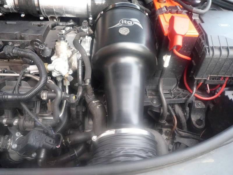

So Andy finished the whole kit and said he was extremely please the way this kit fitted, like a glove as if it was meant to be. The clearance everywhere from the engine block, battery, pipes under the airbox, sensor on the firewall where in the millimeters. Plus there is this cone thing on the battery tray with a gold thread in it, even this clears (i cut mines to be on the safe side lol). I was really impressed with the fit and finish of how this turned out, heres a few pics of the finished kit:

hmmmm, in principle its the same as the pipercross venom kit but nearly £200 more expensive, not sure i could bring myself to spend that much on an induction kit.

Looks like a very good kit, but price is scary at £370+ and those batteries arent cheap either!
