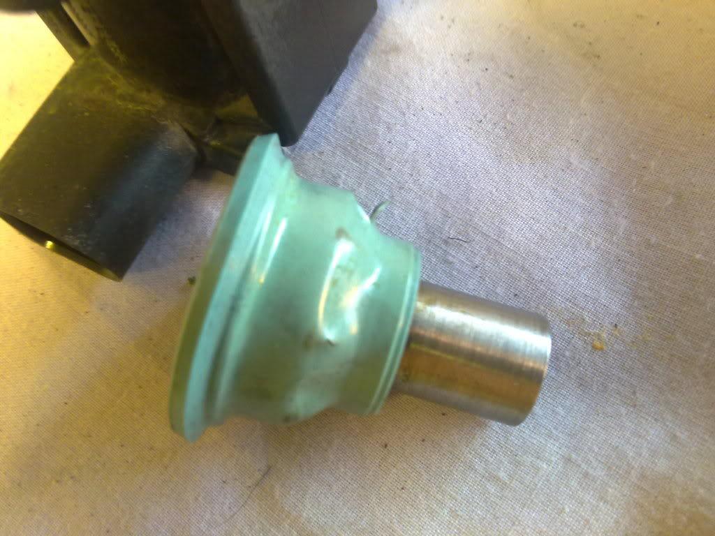

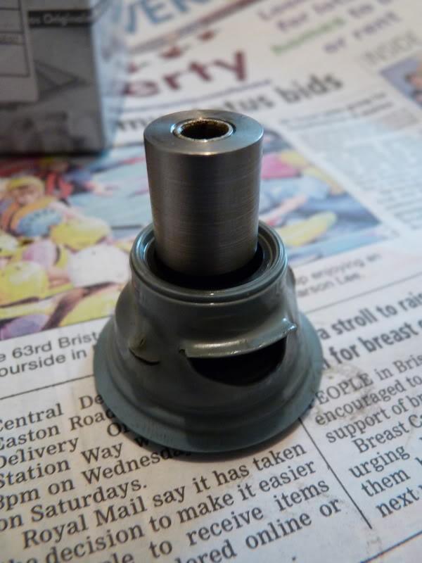

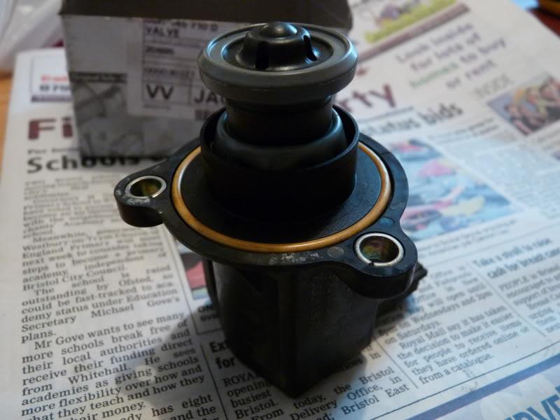

I'll try to get a picture up asap but theres been a niggling whistle from my car a little while now and have been holding of having it looked at until the service was due. Picked up my car this morning after supplying them with the new uprated version and oh my what a difference. Checked the old one and there was a huge hole in the rubber. The old girl picks up like a beauty again, so much so it's like a new car. So if theres a niggling little doubt in your mind about the car get it sorted sooner rather than later. Right I'm off out for a blast  :happy2:
Ok the first one is the diverter valve...doesn't look too bad from a distance

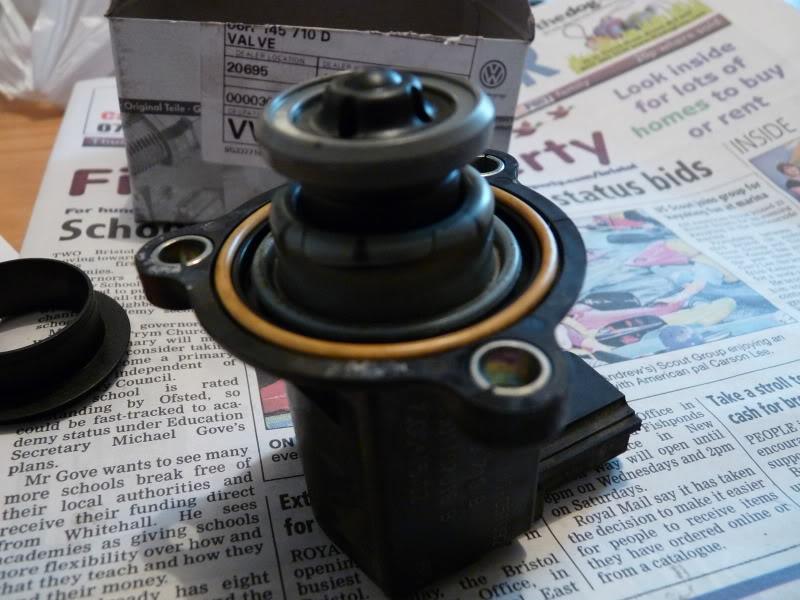

Second one is with the plastic collar removed and you can see a little slit in the rubber

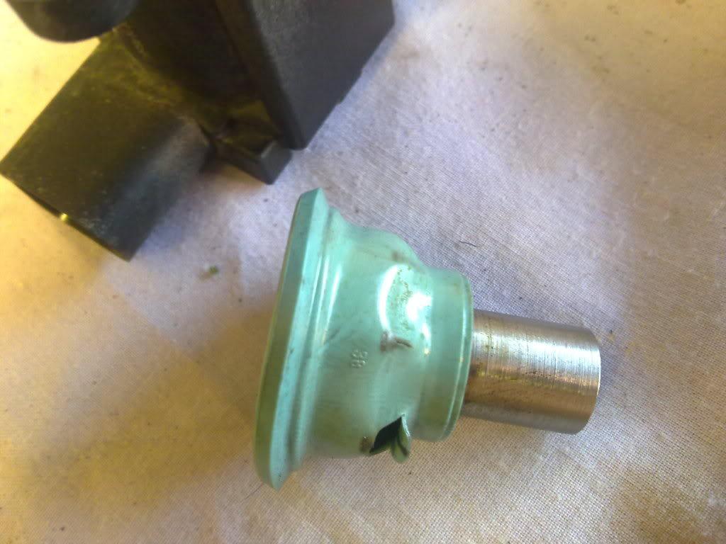

And finally with the diaphram removed and turned inside out to stretch the rubber...oh dear
« Last Edit: July 22, 2010, 06:51:00 pm by dajonic »

i changed mine alst night after weeks of poor performance etc.
here is the old one
two holes there one obviously smaller than the other
another hole
worth checking, mines like a new car
