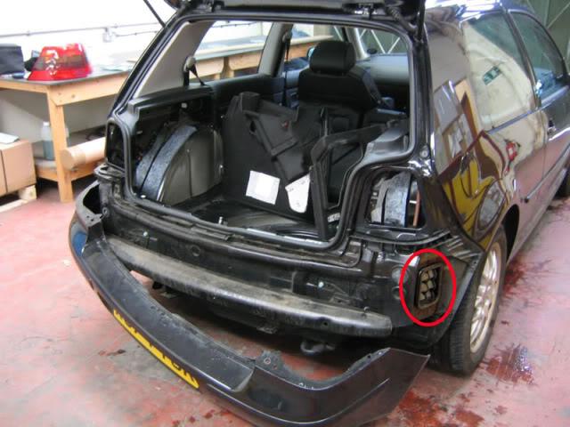

I had a similar problem with my mk5 gt tdi which was driving me crazy. After much searching on the net i found the water was getting in through the boot flap... :confused:  There is a small flap on the right side behind the bumper that allows the air to flow out of the boot when you shut it. You will need to take the rear bumper off but its really easy. I just took it out and resealed it with silicon and have had no water in the boot since.
Heres a pic of a mk4 its in the same place

Ahaaaa cheers for that, I recently had a small bump on that corner so il check it out at weekend, cheers bud :happy2:

There is one of those vents/flaps on each side of the boot as I had the one on the other side replaced/resealed under warranty.  It didn't stop the water collecting in the boot though.  VW offered to carry out a water test for £150 to find out where the leak was coming from but I politly declined their offer!
I managed to stop the leak myself by reseating the rubber thing that goes from the roof to the boot hatch that carries the wires.  Hasn't leaked since I done that!
