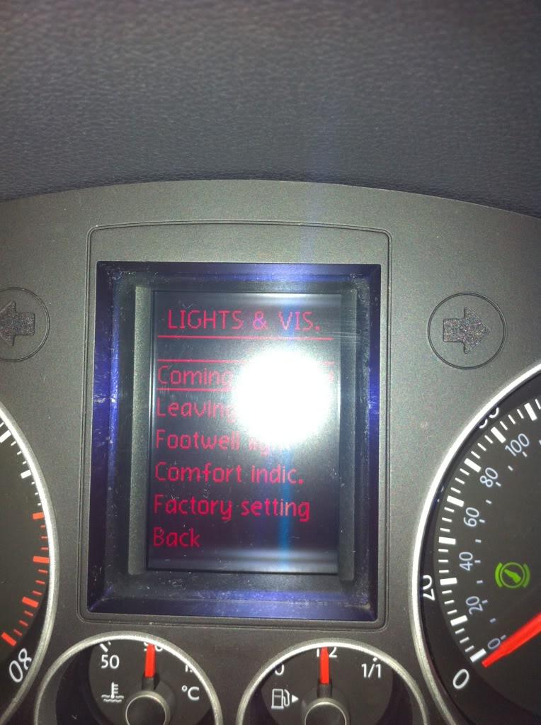

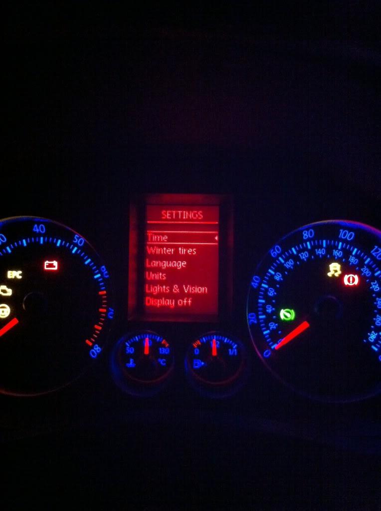

Hey folks! This evening marked a success, I set out to change to a highline dash which was a failed attempt last night... After Darren (MortyGTTDI) mentioned there is a 'easier' way, everything became that bit more simple!
I came back from work, and at 8pm set out to install and program the highline cluster - it was done shortly after! I even enabled a couple of extra things like auto door locking at 10mph and unlocking when taking key out... :smiley:
Anyway, all seems OK so far, I am able to control my Alpine stereo through the MFSW, the track select works, the star button mutes the sound, the OK button, when in 'Alpine' mode, allows me to switch between Tuner, iPod, Aux, USB etc
As for the highline options, I took some photographs, sorry about the quality, it's an iPhone4 but the flash was getting a bit carried away due to it being nighttime, and me being rubbish with it!
All in all very happy! Now I just need to work out how to code an extra key, I only have 1 key, but have a brand new blank transponder and flip key already cut to the car so just need to program them to match is that possible or dealer only?
Also, not sure if im just being paranoid! But im sure my wipers were 'juddering' every so often, like as if they are about to move but the wiper motor is stopping them... They do work as I tried them manually and thats with the 'auto' setting on, I think im just being paranoid though!
No fault codes (apart from the radio but thats due to me having an Alpine stereo and not a stock stereo) I did the adaptation via VCDS to clear the ABS & Steering errors thanks to Darren & Teutonic_Tamer for there help on here last night :)
Sean
